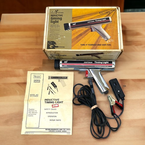

I've got an old Sears timing light from the 70's. No dial. Not trying to toot my own horn, but I have no trouble checking total timing advance without a dial, just by gauging where the timing marks "would be" if the timing tab was longer. Yeah, I could be off by a degree or so, but I don't have any high strung race engines.
Putting a timing tape on the balancer would make a dial not needed as well.
