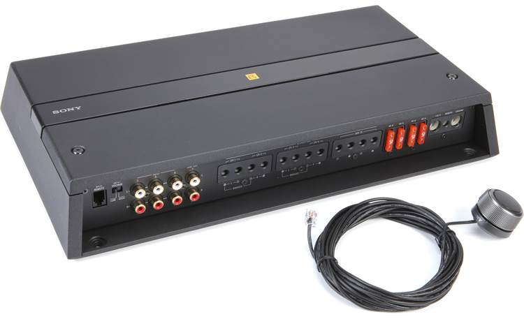

KENWOOD KDC-BT382U CD Car Stereo Receiver with Bluetooth, AM/FM Radio, Variable Color Display, Front High Power USB, Alexa Built in, and SiriusXM Ready https://a.co/d/fTQAhFI
Got this coming tomorrow. I like Kenwood it's very good for the price. With this 5 channel amp I already have.
I can get a better picture when I get home. But it's 1300 watts and pushes 4 speakers and also a sub channel. I had this set up in my 2000 camaro SS with 4 6.5 speakers and one 10" sub and it sounded great. All Kenwood stuff was very reasonably priced. 100for head unit 180 for amp 80 for 10 inch sub and I think like 65 for a oair of 6.5" 3way speakers. 2 pairs. This was five or 6 years ago so they're probably a little more now since everything is more. But great sound quality for the money. That amp would be plenty for you I'm sure. I'm still debating whether to get the kicker 10" sub in the box at Walmart for 129 bucks. Saw them today. One maybe 2 idk yet. I have 2 6x9s in a box also that I'll probably put in the back cab corners. Then some dash speakers too. Still putting it together but that's the direction I'm leaning because the last set up was great. So figured why not put it in the square. Lol
