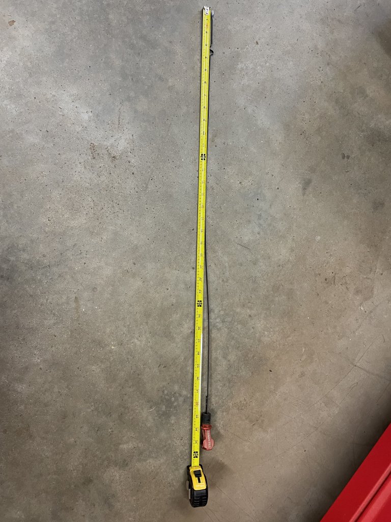

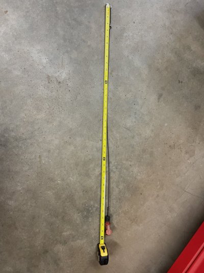

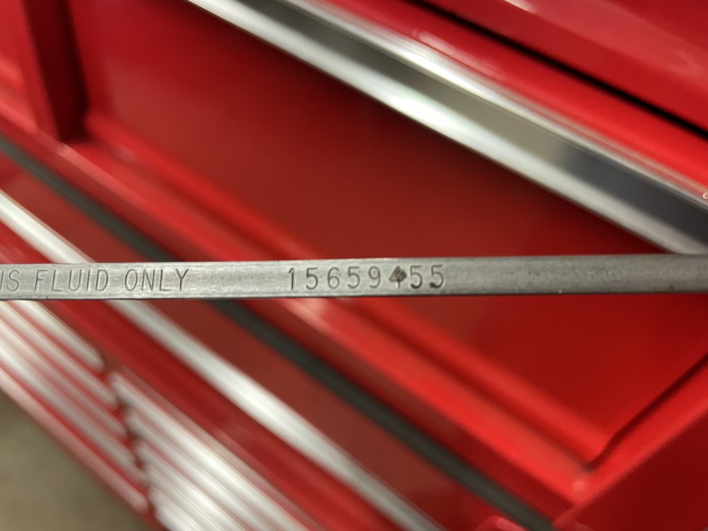

I checked a th400 I’ve got and the actual stick length is 33-7/8”, it would be slightly longer if you included the handle but you want the length of the stick itself. Older sticks have a pull loop and later model sticks have a locking flip over pull handle, because of the different pull gadget designs the total length can vary between the 2 (as well as applications, vans can be longer etc).
Here are my pics, you can see the part number on the stick.
