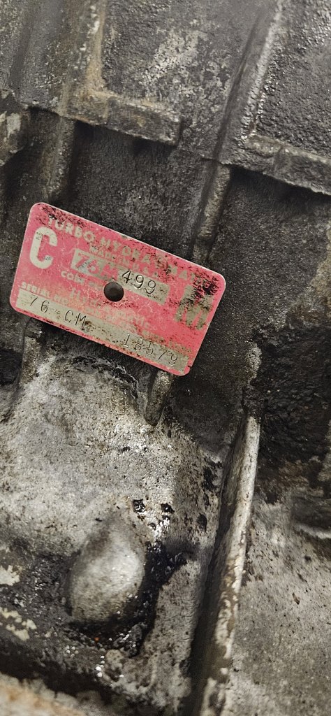

What are the letters and numbers on the metal ID tag?

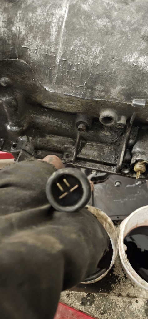

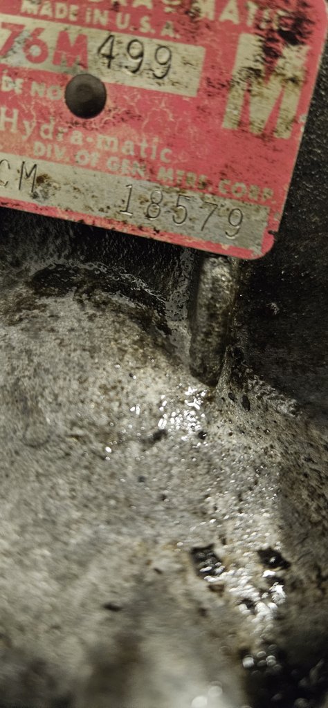

Will send pics of the metal tag and what not shortly

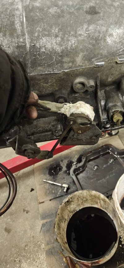

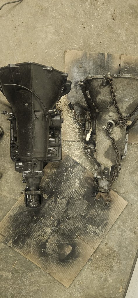

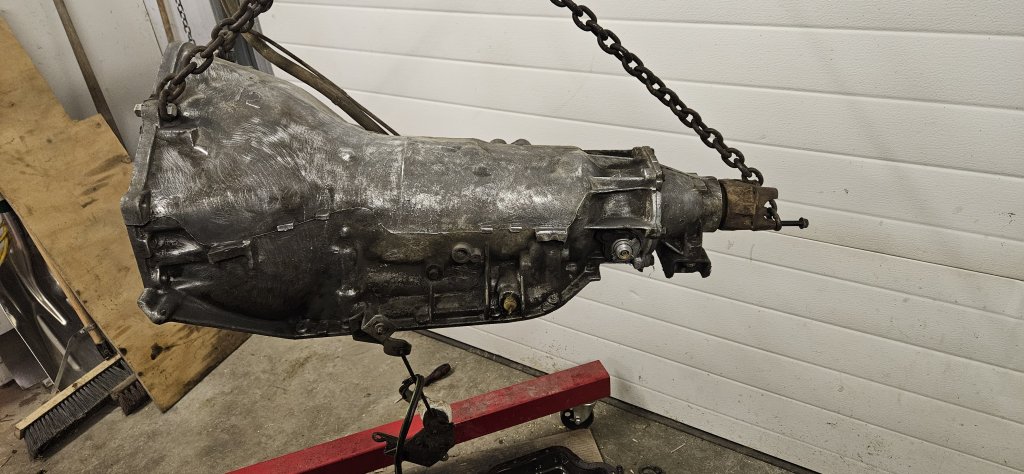

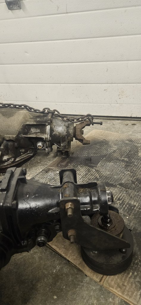

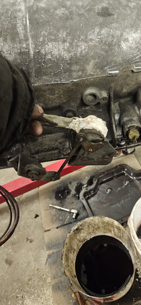

So it's on a rwd 1986 c1500 gmc, running with 3.42 gears in my rear-end with limited slip.

Yep that is a TH400, not a Th475...That said, it may have 6 clutches in the direct drum and 5 in the forward, which was pretty standard fare for Motor Home/Box Truck/School Bus applications. You likely have helical gears, not the straight cut but that's not a big deal.
