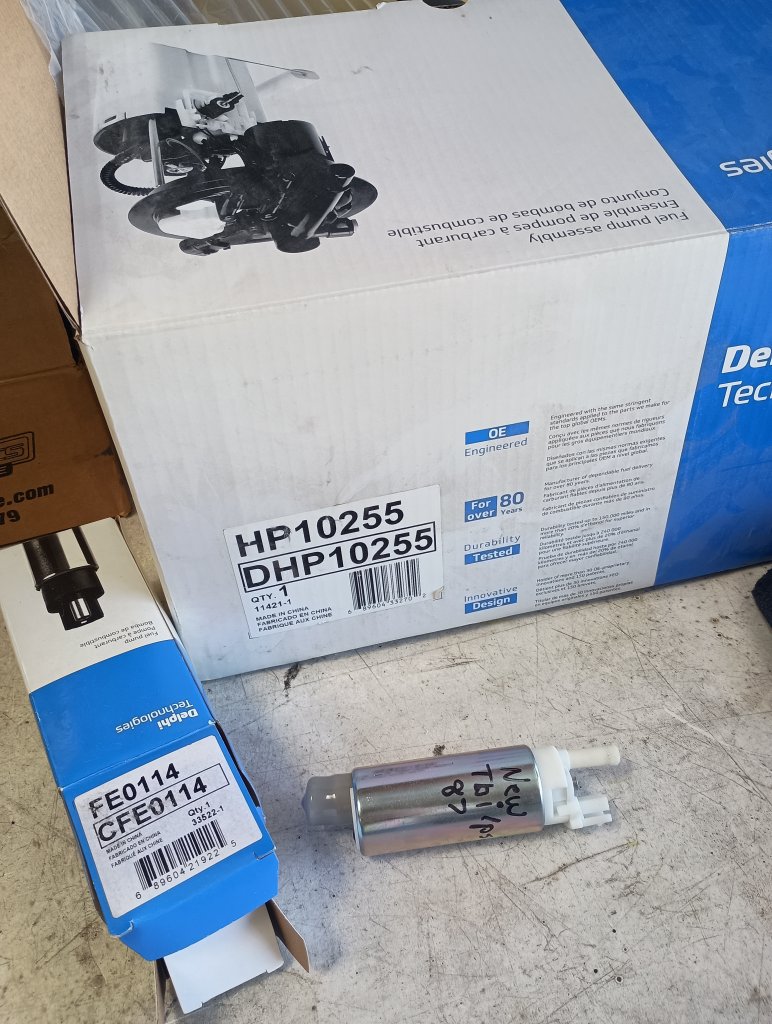

@SquareRoot I really appreciate your help!
I updated my previous post and will probably go with:
Delphi FE0114 pump
Dorman 692044 sender? - Seems like this is the only sendor for a fuel pump.
Or order a TBI pump housing assembly and swap out the pump?
SquareRoot
Mar 18, 2017
4,335
8,439
Arizona
85
Delphi FE0114 pump

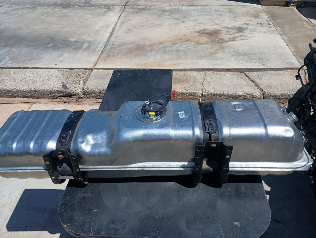

Lol. Very ironic I'm working on my setup today. I just never got around to installing the second tank after rewiring and checking everything. My truck is the second truck I've done this mod too. I used my buddy as the guinea pig. Lol
