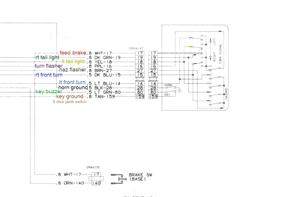

This is so common,type no turn signals,no brake lights into the search bar. This gets covered once a week plenty of info on it.
Jgonick
Jan 12, 2017
571
751
West Texas
Joel
Wires run from back lights to turn signal switch. The turn signal switch provides power from one of three separate wires depending on what is going on- white for brake, purple for turn signal, and brown for hazards. If none of those work- your problem could be the dark green (right back) & yellow (left back) wires being broke , disconnected, bad connection or the turn signal switch. Search and you will find a lot of information on this. see attachment of turn signal switch.

Use the search engine,read about this.Brake and turn share a common wire from the turnsignal switch back. If you have front turn signals but no rear signal and no rear brake lights it has something to do with the wires from the switch to the rear,or the switch itself. There's lots of troubleshooting written about this already.

Check for power at the white wire at the turnsignal switch while pushing the brake pedal. If you have power, check the green and yellow wire while pushing the brake. If you have power there, move on.
Find the tail light connector on the engine side of the firewall connector. Once again, push the brake, check for power on the green and yellow. There will be 2 green wires, one is a light green (reverse lights) you want the dark green. If you have power there, the problem is somewhere between the firewall connector and the taillights.
Look at the wiring behind the bumper, if anyone has ever screwed around with a trailer harness that’s the place to start looking.

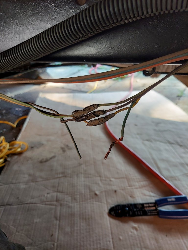

Cyrillious
Aug 25, 2022
165
135
Toronto
Cyril
K10 Suburban
So upon further inspection, I have found that I do not have power from the front to the rear. I have checked fuses, clock spring, hazards, High/Low switch, both relays. I believe it is the wires coming out of the fuse block for the lights in the back. It dosent explain why I do not have brake lighs though.
I had a Similar issue with my Suburban and found the light green wire controlled the brake, signal and hazard lights on that end. It was an open in the wire I found, oddly it was repaired before. You may have the same problem.
