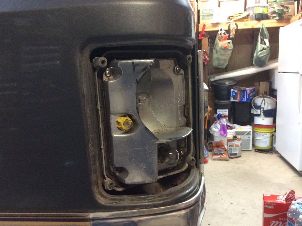

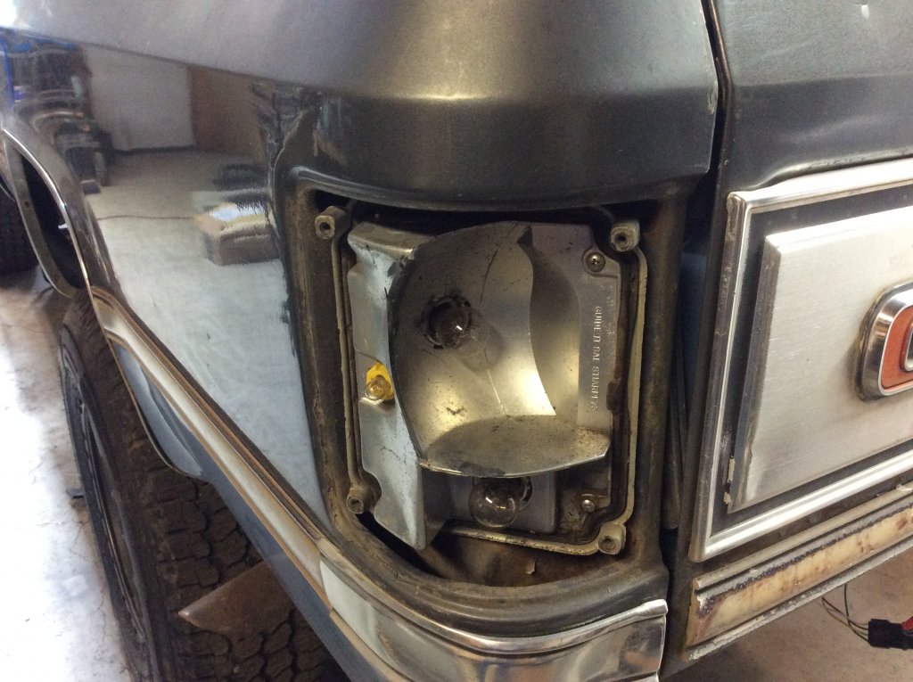

Anyone else done this? Thinking of cutting away this part so to get a little more light out of the side of the tail lights and turn signal and brakes too. Thoughts?
either ive been doing it wrong on 2 different trucks or you have your little bulb socket 194 twisted on the backing there. I always assumed you pushed it in past the 4 "ramps" and then held, because its softer material /rubber. twisting I can only see it possibly losing contact with the bulb sides/contacts

I get exactly what your saying, your thinking if he cuts that, hell be cutting into the back of the light backer, and be exposing an open hole that will get wether into it.
I think that piece is solid plastic, so not a problem, but even it is hollow, that could easily be fixed with some expandy foam or silicone.
exactly, I cut the marked out area away, no exposure to the backside of the bulb holder. so no weather concerns. lots more light out of the side of the lens. I think the LED bulbs will make it even better, I will get a picture soon

Here is a cou pictures of the taillight bucket after I cut it out

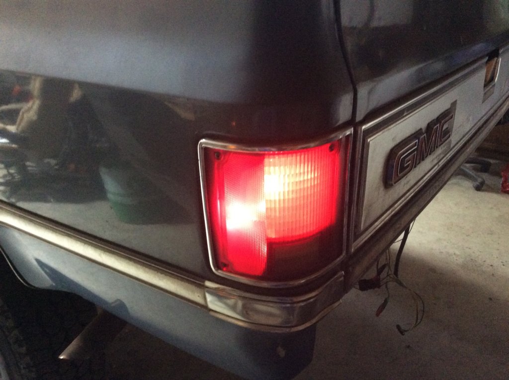

All I did was take out the plastic fin in the bucket. If anything it puts out more light!
