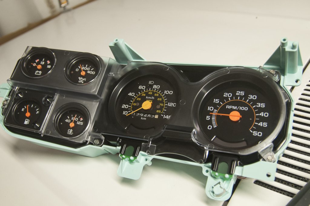

Here's the list of parts I ordered from LMC.
My truck is an '83 GMC Sierra Classic. Parts differ for other years.
This process isn't too hard to do. I removed the dash pad, helps a lot.
Make sure the speedo and tach wires go in correctly so you don't have to remove the cluster after installing it. (Lesson learned)
I used some Testors model car paint for the older gauge needles.
I also, used a small rubber plug for the hole in the lens when the clock stem was. Just to keep dust out.........
36-2042 Tach - 7,000 RPM
36-3104 Tach wiring harness
38-8069 Tach bracket (didn't need it)
36-1858 Small fuel gauge
38-8101 Gauge cluster backing plate
38-8041 Printed circuit
38-1103 Dash bezel - brushed aluminum (handle with care or it will crease very easily)
36-0190 Instrument bulb holders - as needed
38-8042 Retainer clips for printed circuit - as needed
As for the clear lens over the gauges, I polished mine and it looks fine
There's other items you may need like spacers, clips, screws and headlight lens, etc.
Hope this helps !
nice and easy to do :)

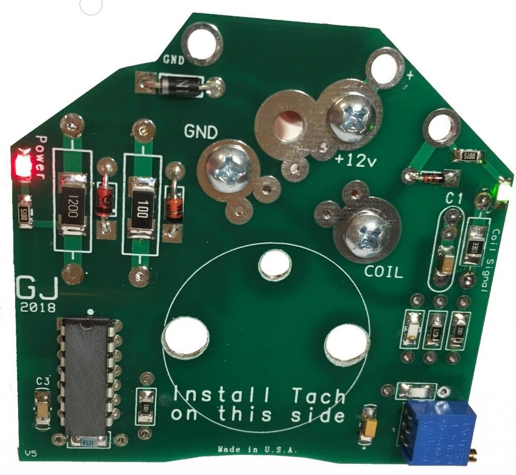

Tell me about that installation. I've seen those gauges I think out of medium duty trucks? I'd like that actually even more than the LMC kit, but my clock would go and my trans temp gauge would go in it's place. So how much work is that installation?
yes from a C50 easy to do with the right part! :)
