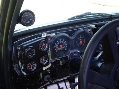

I just mounted a set of aftermarket gauges in the panel and mounted a small tach to the A pillar. It was a lot easier that swapping the wires around in the connector to match a factory gauge cluster. All I had to do was cut the area in the cluster pod to fit the gauges. You really can't tell when the cluster face installed.

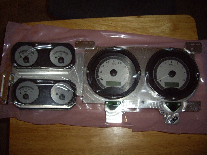

I am getting ready to completely replace the wiring with a 21 circuit harness and when I finish with the harness then I am going to install the Dakota cluster.
Where did you get that cluster from?
