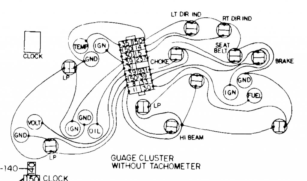

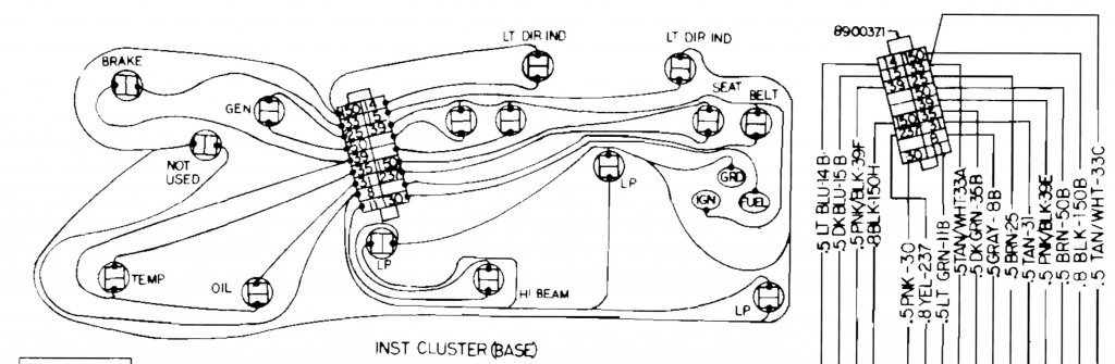

Because of changes between 73-80 and 81-87 I was mistaken about the orange wire in my first reply. There is no 1982 wiring diagram in the reference library here, 1983 is the the closest match. The pics below are the base cluster and cluster with gauges and no tach with the pinout. Go to the reference library on this form and download a copy of the wiring diagram because it also lists what all the wire and circuit numbers are.
As far as testing the gauges I don’t have that info off the top of my head. You could do a search for the subject. I’m sure it’s already been asked and answer on this forum.
