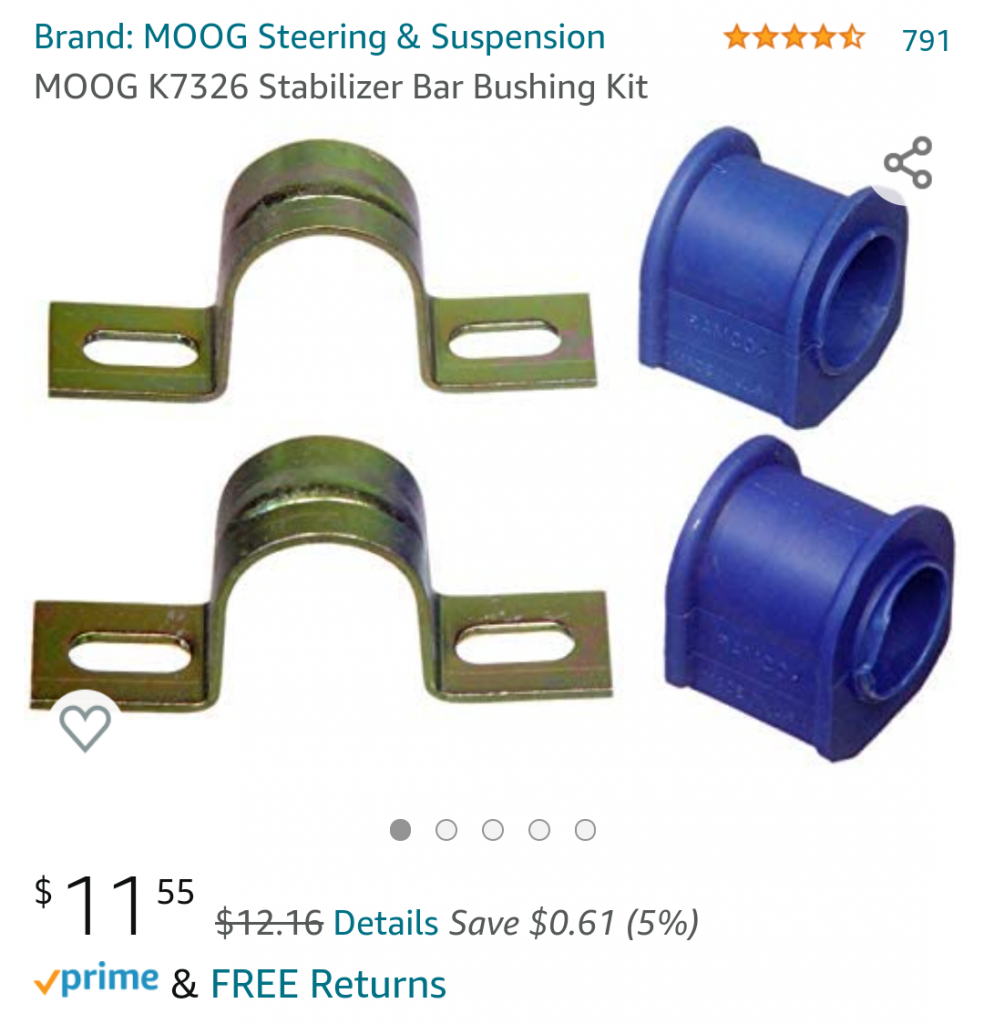

So.... Moog part number K7326 is for the "front" front sway bar bushings. I figured it came with the end links, similar to the ones you linked to. But nope.
From what I could gather, I thought the moog kit I linked to was a "universal" kit? But I'm dumb so I'll take your word for it.

Idk why these would not just come with end links

I have always bought Energy Suspension products. I you call them they can help you narrow down your search for the correct bar bushings and end links. The LMC site only has one style end link bushings, some have longer bolts and some shorter bolts but the same style bushing. But there is no info on the size of the bushings, diameter, or height of the bushing. Unlike LMC, Energy will get you whatever is supposed to go to your truck both front and rear, if applicable. Some bushing sets will have a short bottom bushing and a tall bushing above the short one. They will have different diameter end link bushings to. But most all their center bar bushings are alike with only a couple that are different. It's the end link bushings that are confusing if you don't work with the tech to figure it out. They are usually inexpensive as well.
Also Summit usually has bushing sets that include the end links if you order the "set". They also have just the center bushings as well. I have worked with Energy Suspension on bushings for years with my truck. I have NO rubber in my suspension at all. Even my ball joint and tie rod end dust boots are polyurethane. Energy will work with you to get the right one's. It took us weeks to finally get the correct bushings for my Super Lift traction bars that Super Lift doesn't even make anymore and didn't have any bushings for them. So Energy and I went through I don't know how many until we finally found the right ones.

Thanks for the heads up. I went ahead and returned the moog bushings and purchased the front sway bar set from energy. The one extreme linked too. They should get here today.
