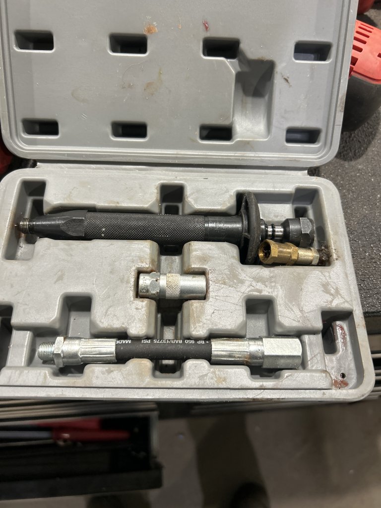

Lincoln makes this kit however there are others out there , I believe harbor freight carry's one . Some are very stubborn, you pop these with a good lick . May take several hits
