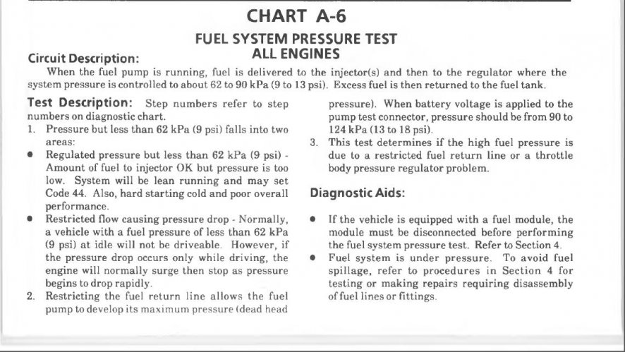

Isn't a TBI supposed to have 14-17 PSI? You might be right and just a hair low on the fuel pressure. :shrug:
According to the factory service manual its 9-13 psi with a pump dead head at 13-18 psi...... I have about 12-13 right now with the regulator cranked up.
