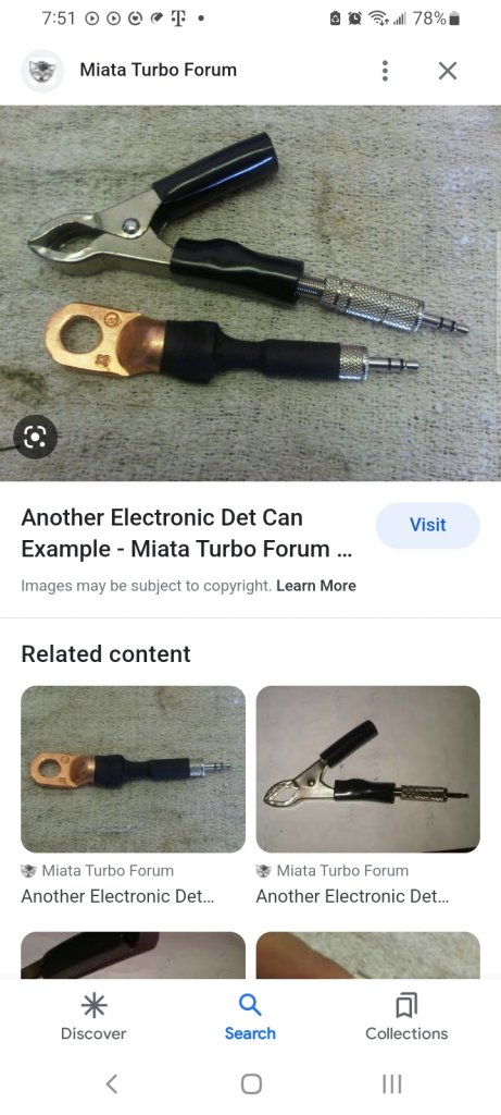

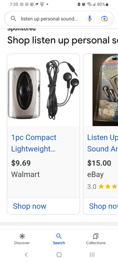

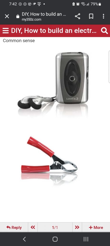

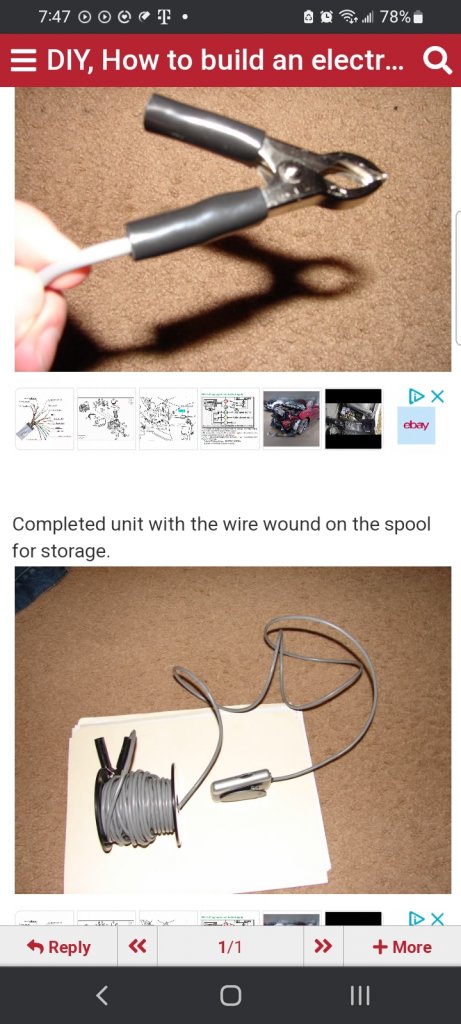

Seems guys are taking these personal listening devices from Walmart taking the mic out, fitting the mic inside a battery charger alligator clip or in an electrical lug and making a long electrical lead. So cool,you can listen under the hood, next to a wheel, bolt the lug down to listen for knock whatever, while you are driving. Look at all 4 pics. You'll understand. I put a link to one guys build, for 10.00 I gotta have one.
