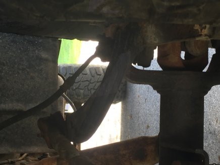

So that's what it looks like

You have a raised arm
