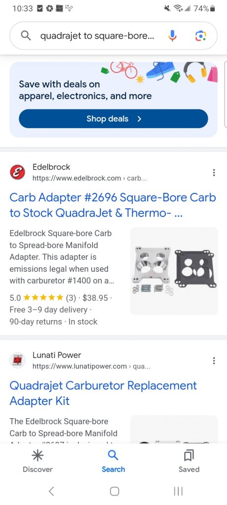

I'm a believer in keeping dual plane manifolds dual plane,which an open hole adapter doesn't do. I put up two screen shots, one from lunatis website,1 from I think it was Edelbrock If I was dead set on running an adapter,I'd be using the edelbrock adapter. I've seen them as cheap as 20.00 new.
