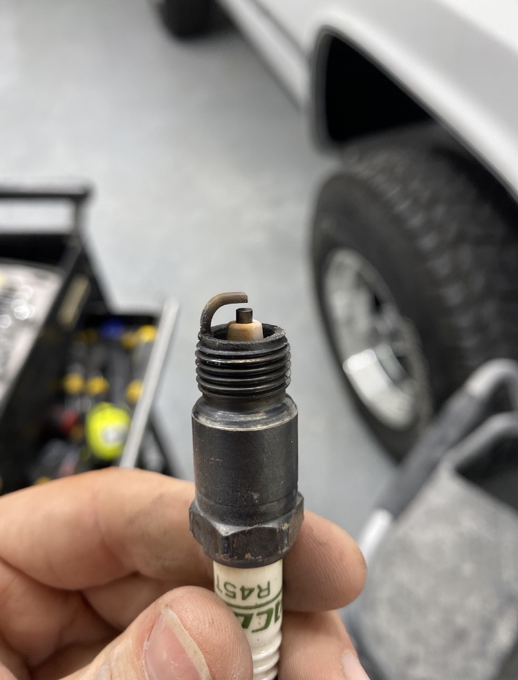

@Jwernatl You ever figure out your spark plugs being half white, have black? I have the exact same issue. 10 degrees advanced. Chevy 350. No clue. AC Delco R45TS Plugs.

i would think your combustion chamber is not consistent inside, possibly carbon deposits heavily on a part, maybe a oil control issue in one spot, maybe a chipped piston if you push any power or got a little pingy
Otherwise I would think maybe you have a AFR thats changing like a gummed up carb? you into clocking those bad boys? How old are they? They havent used that number for a long time, but i cant judge thats in my engine right now. long trips, short trips? tsat?
can you flip that plug over and show the ceramic and note anything on it. i see some hot looking baking near the bottom, is there any carbon tracks or is the rubber boot have any contamination on it thats interupting the seal in the wire?

@AuroraGirl Every single plug is the same. Could be, but I doubt every piston is chipped, cylinder has hot spots or has same carbon deposits.

hmm. i would look at the ignition side of things or a camshaft to crankshaft issue, such as a maybe chain installed off proper or gettting worn. otherwise i would say it should all be contained to the distributor based on how i would approach it. if you were gonna ever have stuff off for timing cover seal or maintainence, worth a look. but if your distributor is old or coil is old, maybe worth trying some different units for a monitoring of how it goes
