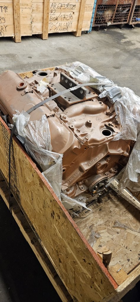

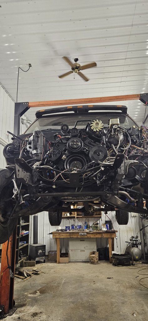

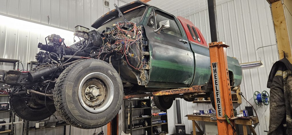

Hello everyone.
The time has come for me to upgrade from a small block 350 to a BIG block 454. This is my first big block and swap and I think I'm kinda jumping into the deep end with this. What are some things I need to know for the swap. I am putting this into my '86 Sierra Classic 1500 and currently have a TH350 transmission, dual exhaust set-up (header back & 2.25" pipes), I'm running an electric fuel pump and regulator, electric fans x2 on a 3 core radiator.

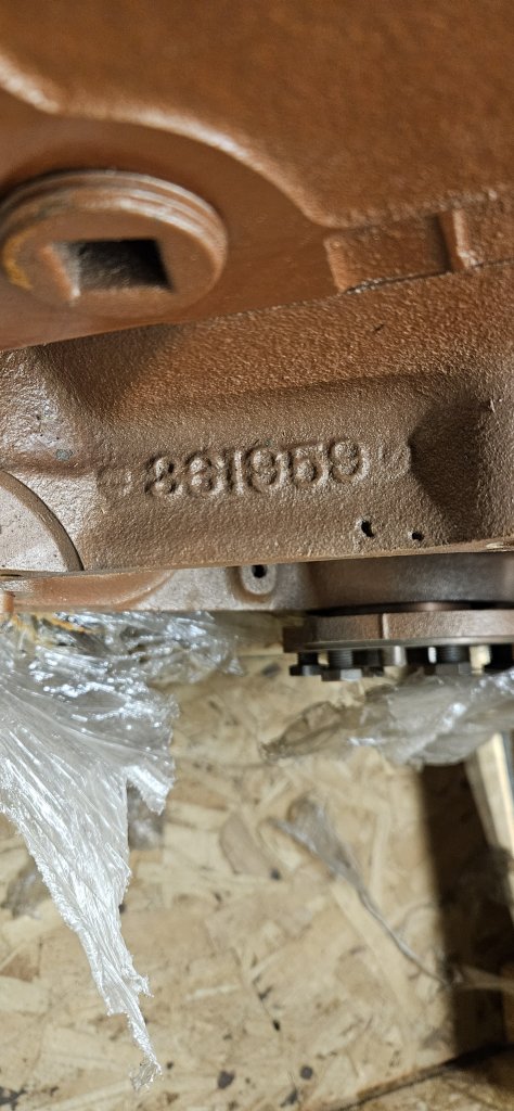

What are parts off the 350 I can swap over to the 454 to save some time and money in the swap. The 454 is a Gen IV, with the casting number 361595.
Some tips and insight is appreciated.
