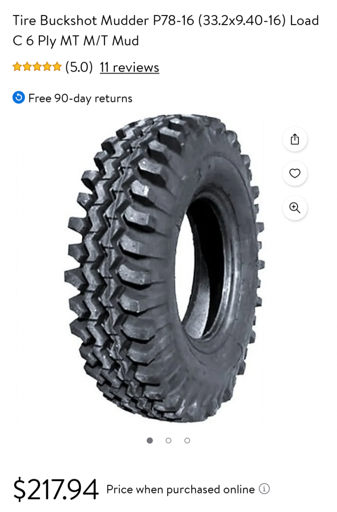

I was looking at tires that might fit the stock 16x6.5 rims I have. I believe those numbers are right, please correct me if not. Anywho, I was thinking of getting a set of 33x9.5x16 buckshot mudders and was wondering if anybody else has run a tire of that size on the stock rims with any luck, or problems.

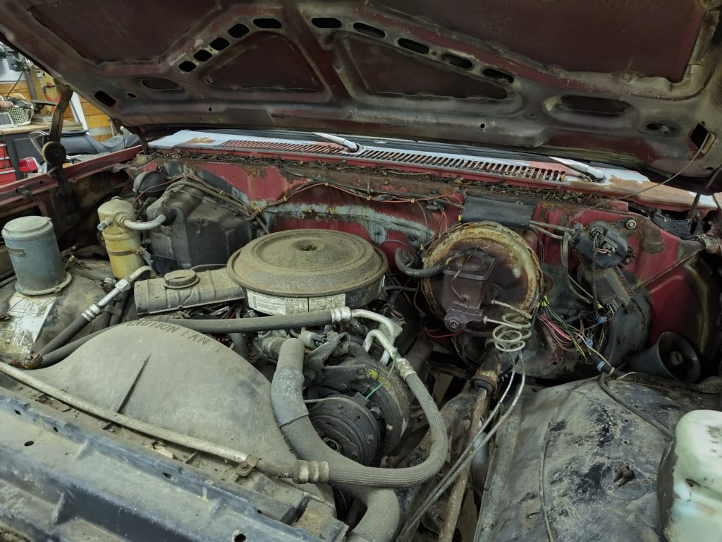

Yeah, I'm leaning toward a mostly stock look, considering even keeping all the OEM stuff under the hood too, but with a fuel injection setup under that breather. I just want a slightly larger and more aggressive looking tire on a stock rim.

I would think those tires would fit fine. The Interco website should tell you the recommended wheel width for each tire size.
Be prepared for short tread life. Small, narrow bias ply tires will wear fast on a heavy truck. I’d realistically expect 15k miles or less.

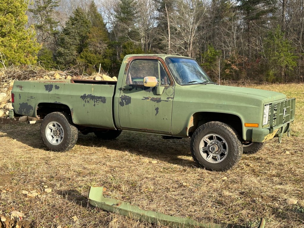

If you're not hell-bent on keeping your stock 16" wheels, I run LT255/80R17 Nittos on Hummer H2 wheels on my '86 CUCV. They're a 33" diameter. I absolutely love the skinny tire look...have for decades. It's an all-terrain, but has side lugs that give it a more aggressive look. 17" wheels also open up a lot more options/sizes than 16", as well.
I ran 34" x 9.5" swampers on an old military Jeep, and definitely noticed rapid tire wear with those FWIW.

Tire wear varies greatly between tire makes and models. But I'd agree that 15k is a safe estimate, although I also wouldn't be surprised if they lasted much longer.
