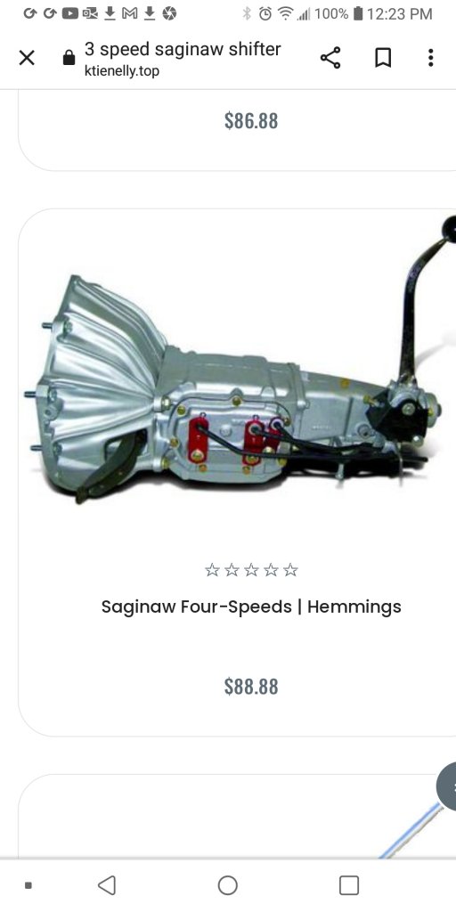

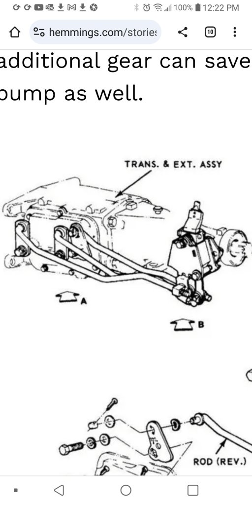

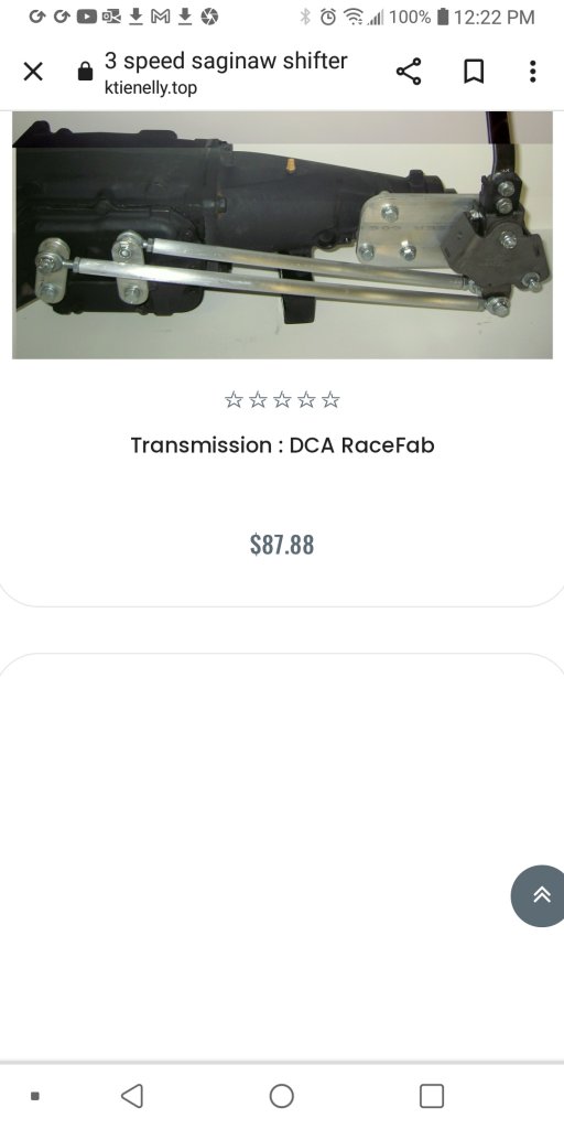

I had 2 bass cannons both got stolen. @410 John. Heres some pics for you. Factory 4speed Saginaw and Home brew 3speed saginaw shift linkage. You can use that 3speed picture for the four speed linkage , but know you will have to make a reverse rod. You said your going saginaw 4 speed to make the truck more fun. Be aware the saginaw was the low performance transmission. Small tire 4 cylinder,6 cylinder, and under 300 hp V8. Are you getting the bellhousing with the saginaw? Something to think about is an s10 4.3 t5 swap. Shifter and transmission 300.00 pick n pull. Then you could run 3.73 gears but have reasonable hiway rpm.

If gm mounted it to the crossmember rather than the Transmission it probably was because the tailshaft wasn't located, where the shifter needed to come up.. Damnt post 19 I meant to put up pics. Here they are
