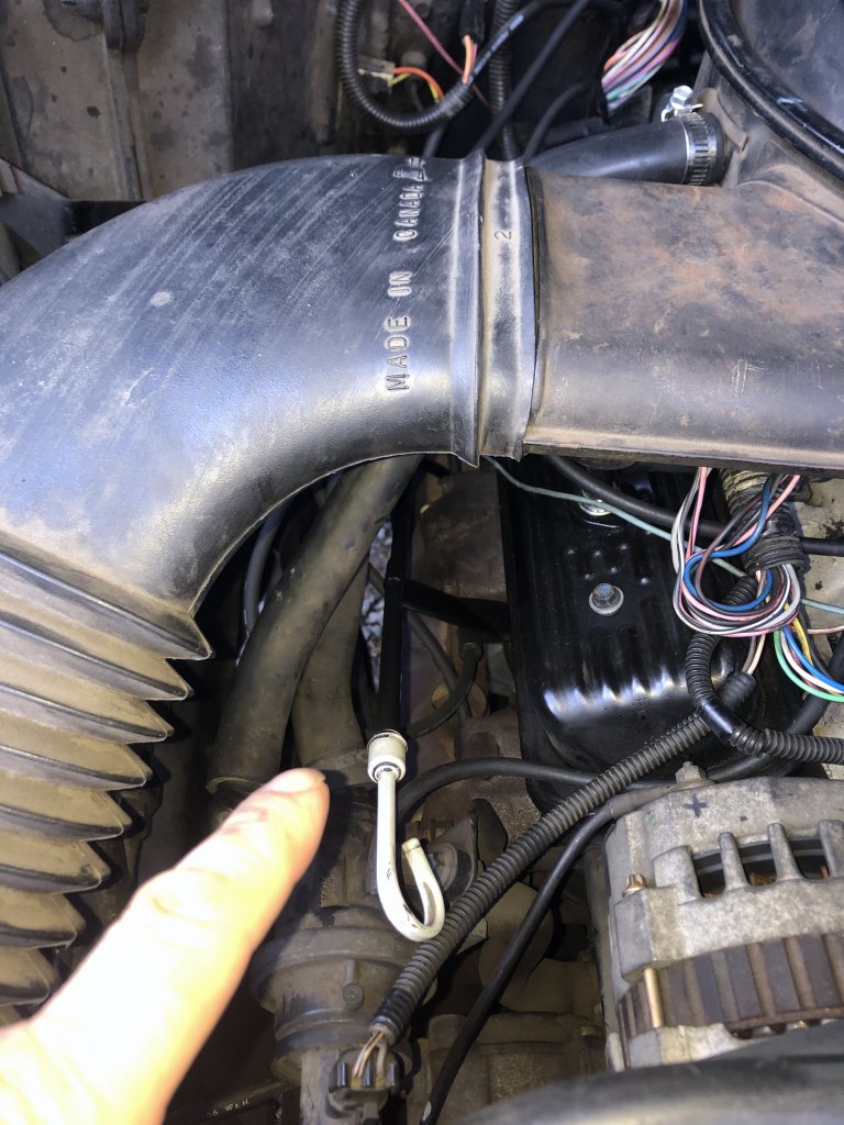

After I cranked that idle screw to the right . I gave it some gas lightly here and there to keep it from stalling. I then it got real poppy sounding on my exhaust manifold I’m pointing to here. It actually sounded super bad ass and then I walked over to the muffler and had a strong popping sputtering sound.. but when I shut it off I heard a a lot of swishing around of fluids And bubbling of fluidsaround my radiater possibly that was unexpected how I’m guessing it got real hot it sounded like it had 800 horse power lol

Took it to the mechanic my timing was too advanced, loose exhaust manifold bolt loose. The rubber on my radiator cap was gone this caused my coolant to back up in my reservoir 280$ covid price not too bad
