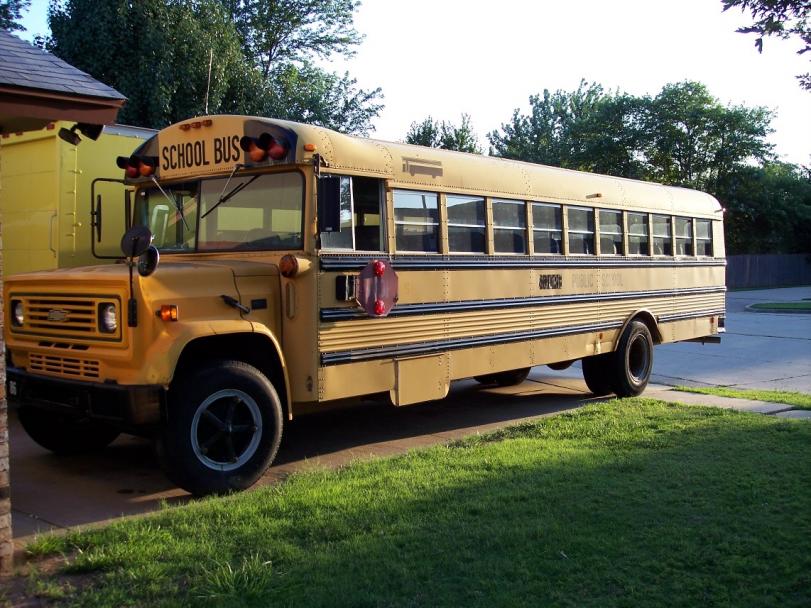

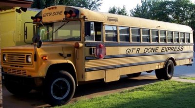

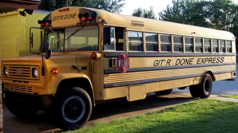

LOL, you're that guy Hot Rod
The city is usually on my ass about where I park my box van. In OKC area, we don't like Ryder Vans as you can imagine.
hahaha, I only had it for about 10 days. I bought it for $700 and Sold it on eBay for $1300. A guy flew here from Washington and drove it home. Sorta.
I was fun. To make sure it was road worthy, I drove it to my dads property 75 miles East of here and back. It ran 70mph just fine. More if I wanted, but 70 reasonably. My son, 11yo old at the time, got to drive it out on the state hwy toward my dads house. I figured since I can stand right there, take the wheel, hit the brake and all, that if he goofed, I could catch it. We named it, Git'R Done Express, and I did some photo chopping on the pic too.
