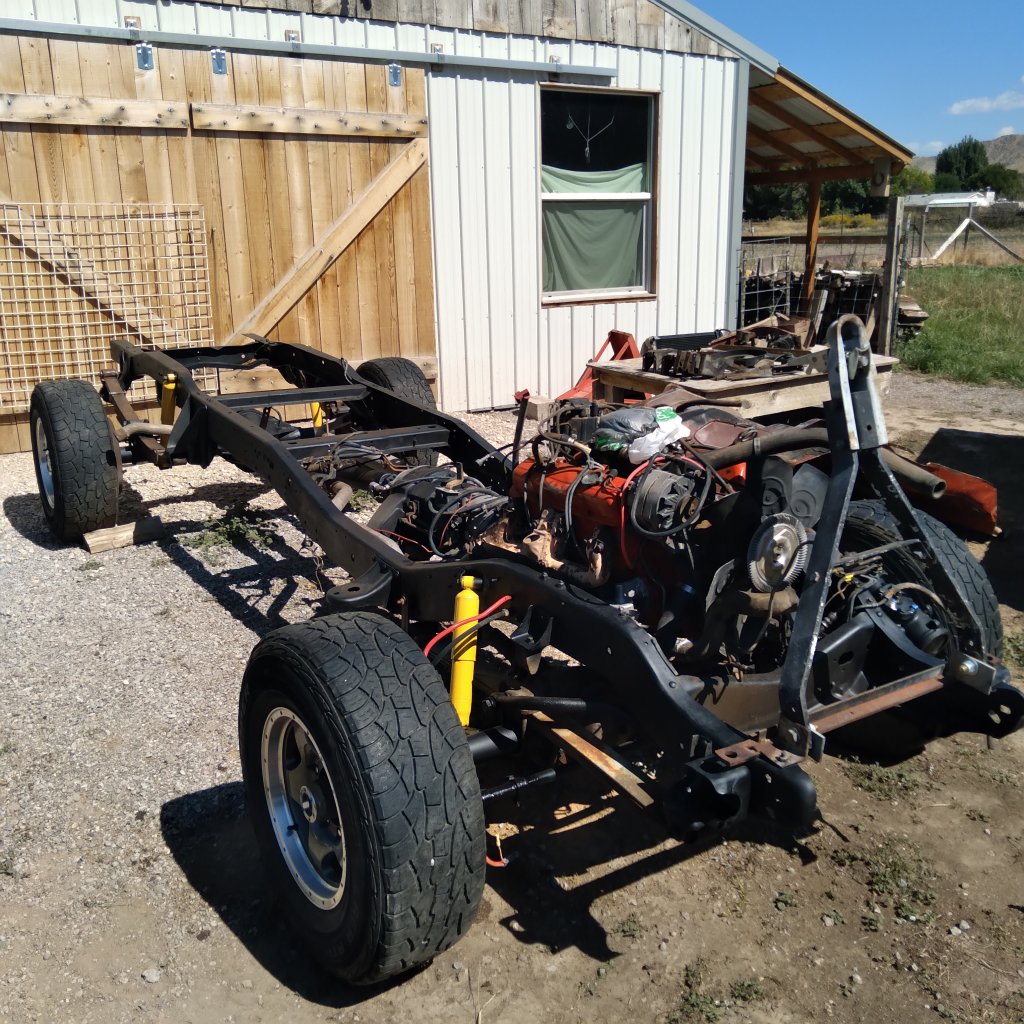

I'm doing a body swap using a '78 Chevy chassis including complete power train, and a '58 M37 military truck.
I saw some saddle tank delete threads but nothing on earlier trucks. Mine is a 1978 K20 Camper Special and the fuel tanks have got to go.
I've seen that later trucks are using a 31 gallon tank from a blazer which I'm assuming fits between the frame rails behind the axle.
I found a 40 gallon tank that fits a Suburban listed here: https://www.classicindustries.com/product/1978/chevrolet/k20suburban/parts/ft5016a.html
and I'm wondering if anyone has experience with using this style tank in a pickup?
I really don't want to buy a 40 gallon tank if a smaller tank will fit better, so any help will be much appreciated. Especially if you've actually done or helped to do what I'm doing.

1 40 = 2 20s, go big and be done with it

Yeah... but will it fit without being a pain in the a**?
It fits on the burbs. There are a couple members that have done the rear tank installation on their trucks, hopefully they will chime in. I still have two side tanks and plan to keep them as long as I possibly can.

Body swap to an M37.
Is there some kind of reason to keep them?
I forgot your username, so I also forgot about your unique project.
First check with DMV to see if your project is feasible, and only then move forward with modifications.

Use the M- 37 tank.
