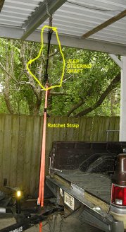

Improved way to compress/extend Jeep Shaft
Today I bought and prep'd two (2) Cherokee steering shafts
Not too sure why so many folks use torches to burn out the internal plastic inserts. Breathing toxic fumes and ruining the paint only to have issues getting the resultant slop out of the shaft and possibly damaging the upper u joint-shaft connection doesn't seem like a good 1st choice. Jeep engineered these shafts to properly function with the internal plastic inserts.
I used a pry bar to easily compress/ remove both shafts at a Houston pik & pull.
Hung shaft from the rafters of my shop and pulled down with a ratchet strap to the bumper of truck.
http://www.bacliffrv.com/TruckParts/Jeep%20Shaft.gif
Shafts easily separated with a few love taps from a 16 oz hammer. Used a file to remove a little material around each insert. Installed using plastic hammer to get shaft into final position. Working great!

A close up of how you hooked that up would be great. I'm wondering how you got around the U joint and kept from tearing the U joints apart.
