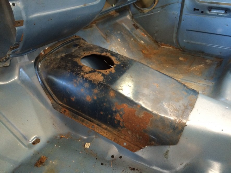

Still looking for a trans hump. Going to the salvage yard this weekend. Unfortunately its hornet and yellowjacket season.

Like a glove!

OK, So what did the hump come out of? Year, Series and Power train? C10, 20 or 30? K10, 20 or 30? Manual trans truck? and Year.
Then, what exactly is going into? Your cab. Year, OE Powertrain and Series?

It came out of an 83 i believe. I looked at like 20 trucks twice. No motor or trans in it but it was two wheel drive.
Puting it in an 84 low hump auto two wheel drive cab that is going on my 87 R3500 frame with an SM465.
I cut the back lip off of this hump as well as the last two bolts and bent the flanges down to a 45. Fits great! Sorry I don't have more info. It wasnt bolted into the truck so I grabbed it. I found a cab with a floor like mine and test fit the humps I found to determine which one to use.
47,181
9,435
10-4. I didn't realize as late as the early 80's had the bolt in hump. I thought that was all pre 80. Good to know. I might just end up using my 84 C20 Cab after all for the 85 K10/K20 project.
