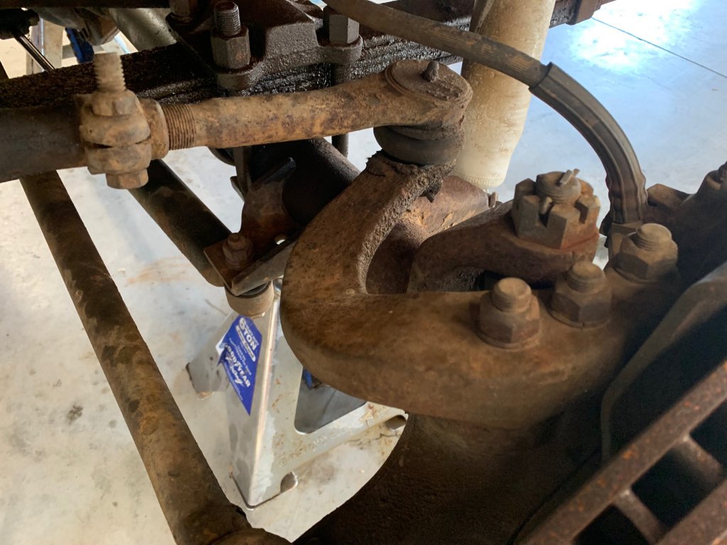

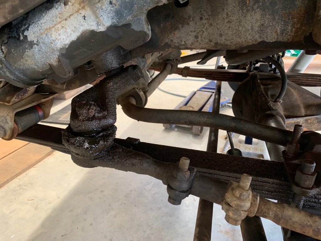

Thanks @Grit dog and @78C10BigTen , have been focused on other areas and didn't consider the steering.
Wife and I are old, have a small horse farm and cant climb into things (especially with our Border Collie) like we used to...stock height it is for us.
What do you think?
Maybe I need a stock steering arm?

I may be wrong, but I think that is already the stock steering arm and pitman arm. For a about a 3in lift, you don't HAVE to change those items.
