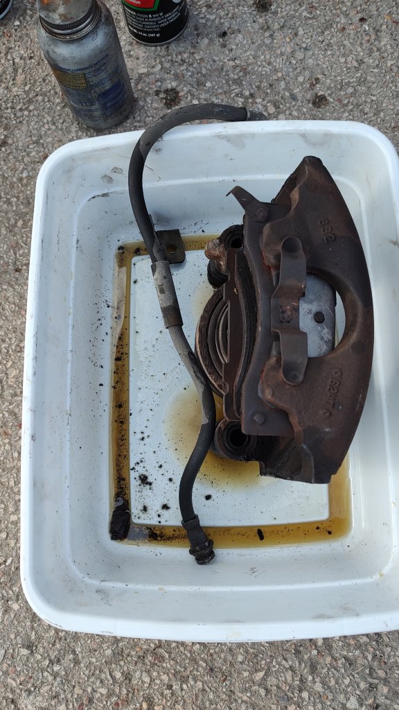

If you have not replaced the brake hoses, it may be time to do that. Bits of rubber come off the inside of the hoses and clog the calipers so they stick. Had this happen on my OBS Burb a few years ago, and just recently changed calipers, hoses and pads on my one ton because it was beginning to have this problem. And the calipers and hoses were the original parts so it was time....
All the small black specks in the washtub are the rubber bits I'm talking about. This is the driver's side, but passenger side was just as bad there.

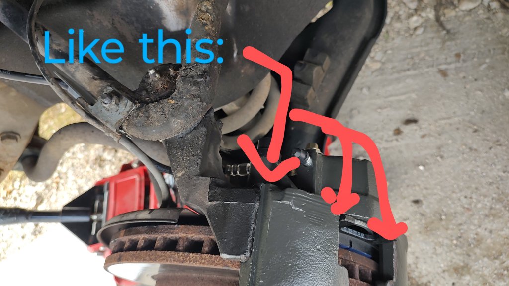

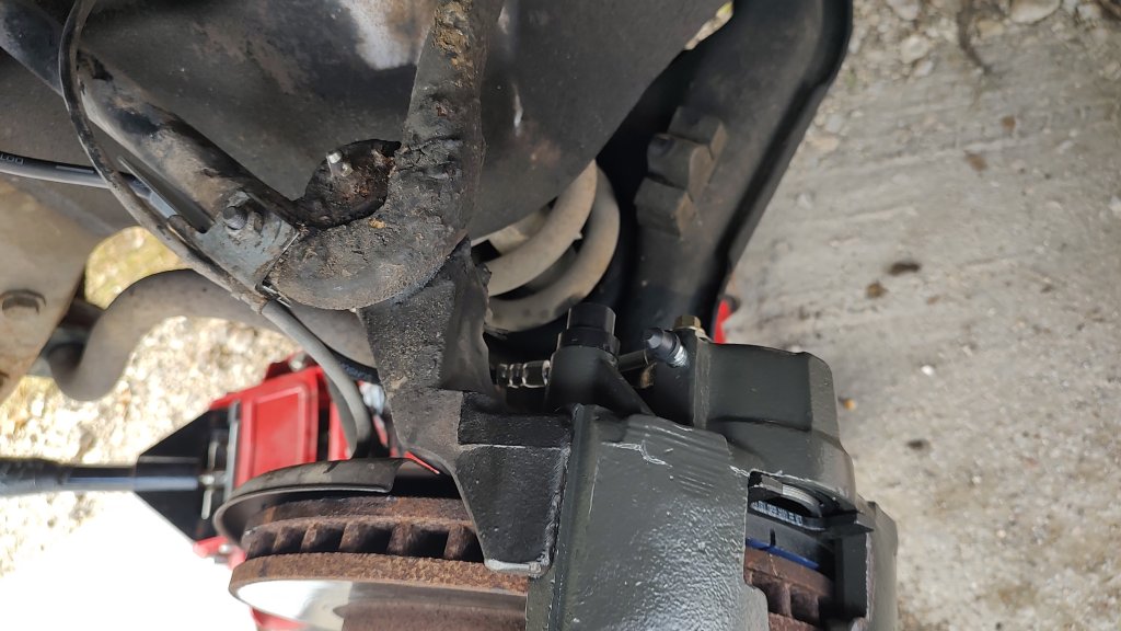

Second picture, you can just see the edges of the inboard pad, and the slight gap between it and the rotor.

Yup, calipers can stick for this reason too. Best thing is to replace the calipers and hoses; then you know you have clean parts. And on my one ton it did not take too long on either side, even with cleaning up the mounting surfaces so they can be greased with hi temp brake grease. Square body caliper pins/bolts don't have sleeves on them like the OBS brakes do, so it's easier to get everything properly lubed. The sliding surfaces need to be cleaned and lubed too.
