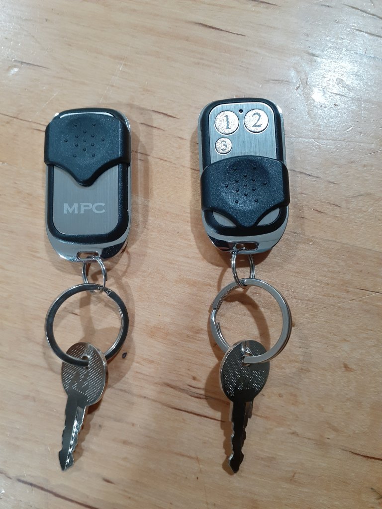

Here is some info on the system. It cost 100.00 when I bought it a couple years ago. Second pic is the key fobs. They have a sliding cover to prevent accidental activation while in your pocket or elsewhere. Can't speak to reliability yet as car isn't quite finished, getting close.

After thinking about it I did have a problem with the system. The #3 button on both fobs for the trunk does not work. I operate the trunk with a wired button inside the gas filler door. I called the supplier and they would not cover it because I had bought over a year ago. Point is don't buy electronic parts till you are ready to install.
