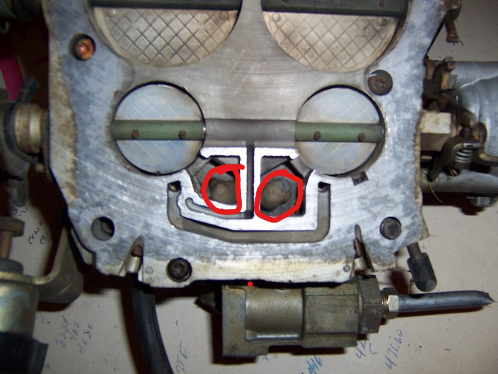

Upon further investigation, it looks like fuel is running leaking out right on the passenger side of the carb. Is this a result of a well plug leak or something else. My gasket is plenty tight....
2,002
2,883
Picture? A well plug leak usually isn't visible. May be fuel is migrating out the throttle shaft?

I drew a blue arrow pointing to the area where the fuel weeps sometimes.
