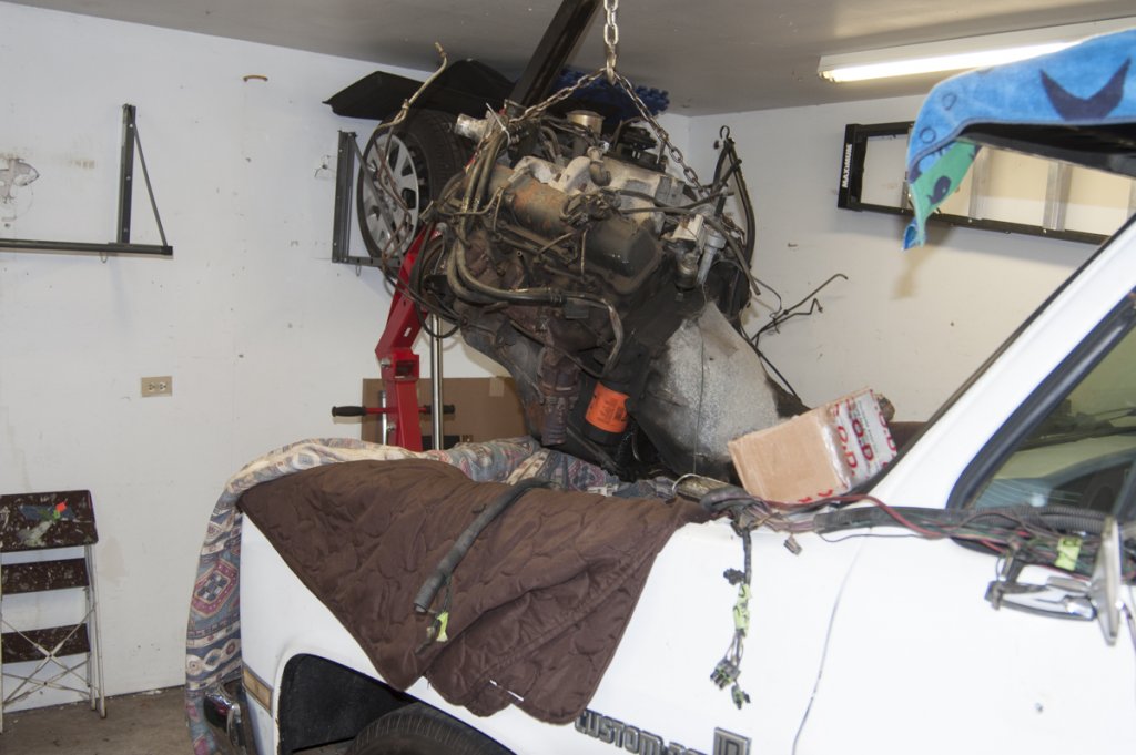

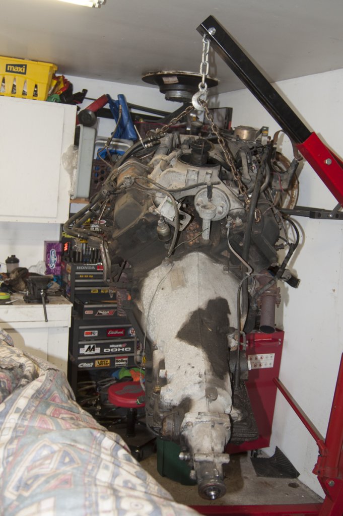

I've got a 1982 c10 with the 6.2 diesel and 700r4 trans. Long story short the starter mount on the block cracked (unbeknownst to me the starter bracket was missing so the starter kept moving around while cranking), and I need to pull the motor to have the block welded. I hear the diesels have to be separated from the transmission before pulling, but I don't know how true that is. Has anyone here attempted this before? Thanks
yes you can! :D

yes you can! :D
That is a "man" of an engine crane you have there! My engine stand and crane were screaming this past summer when I put a 6.2 in a Silverado K5. It had a broken crankshaft and it was aggravating getting the torque converter bolts out. Thankfully this was accomplished and I didn't need to pull the transmission too. It would have been terrible because it was also 4x4.
