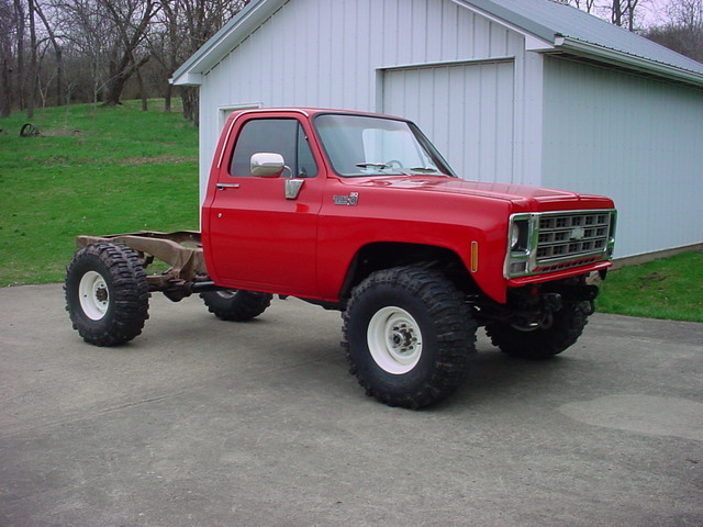

With as much access as you have to the top rivets to put new ones in, no reason to fight trying to get that in with it together. I'd lay money the factory riveted them after too. Once I did it that way I wondered whether the weatherstrip manufacturer avoided saying to do that in hopes of people just buying their refurbished ones once they fought trying to do it. LOL I would be interested to know from those who have bought a refurbished set if there are new rivets at the top. Anyone?
Here is a pic of mine after it was all put back in.
