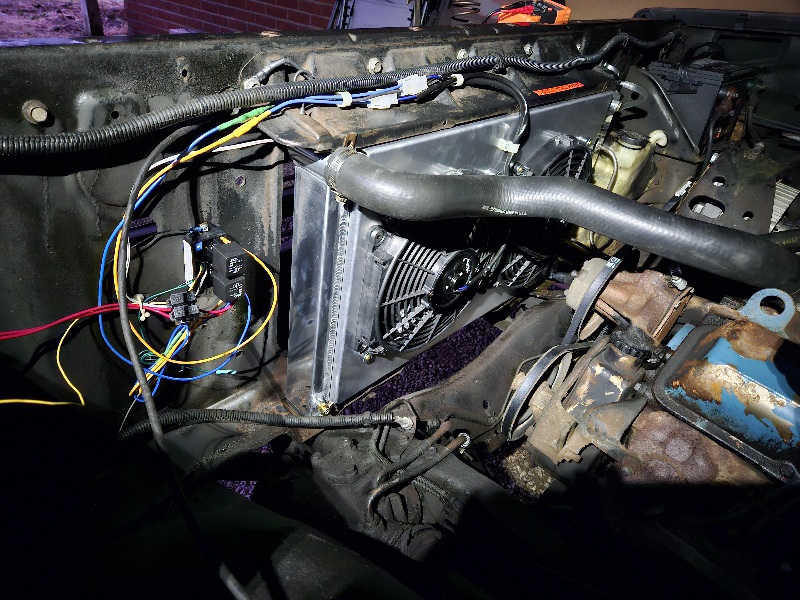

A trip to Summit Racing got me a deal on a 3" core rad with dual rows. Kit included dual fans and shroud. The heater core was order out of a catalog. I also ordered a bypass valve.
So pulled the fan and huge black plastic shroud.
Holy smokes does that open up the bay! Wow! I could hide people in there...lol
A couple clamps, tranny lines, and a few bolts later and the rad was on the scrap heap. The new rad was only 1 inch short left to right, everything else was perfect so getting it in was no big deal. The fans and shroud had been married on the livingroom floor earlier. And, No, I did not use those plastic zippy straps to hold it all together. I did not like the idea of molesting rad fins to put it together. There are plenty of places to drill and bolt it together.

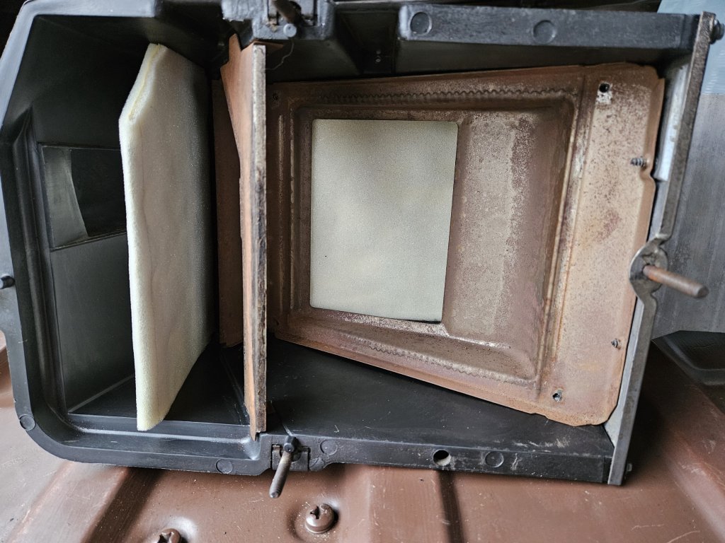

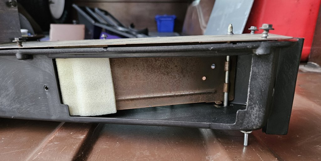

Then the heater core was pulled. The heater box was cleaned up and new foam was cemented to the damper doors. That too was not at all difficult, just a bit time consuming.

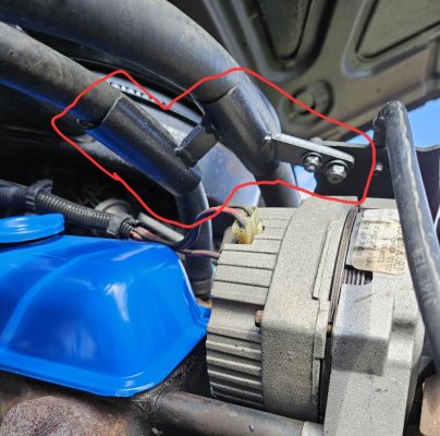

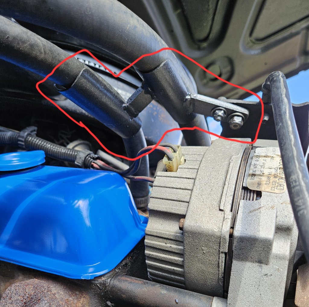

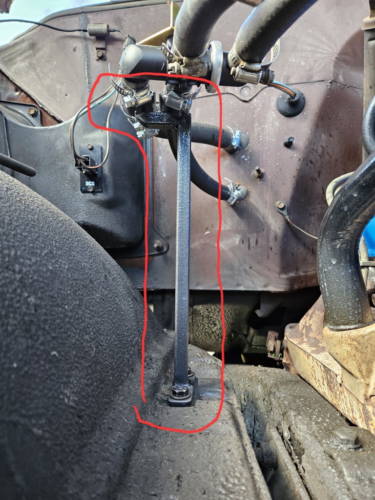

After running it for a few days, I decided to make a couple hose saddles because both heater hoses were rubbing against the alternator bracket and the bypass valve was just dangling in mid air and that just won't do.
