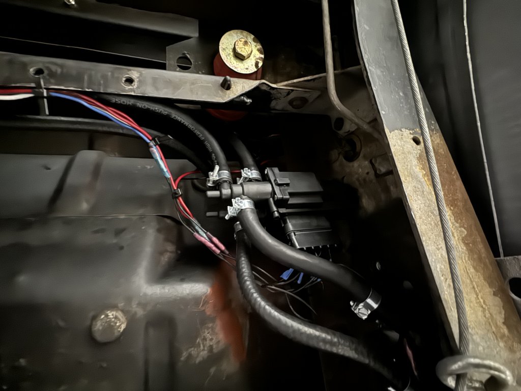

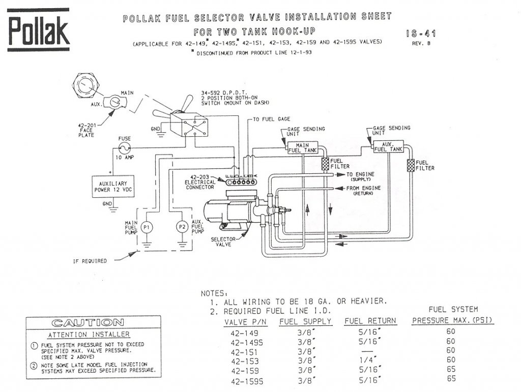

Hello all, just got my '77 K10 back from a 5.3 install, but having trouble with the selector valve. Got two brand new tanks from Tanks inc or PSI Conversions with Walboro internal pumps. The guy who installed it said the system runs between 58-62 psi and had a gauge on it to confirm. Just purchased a new 65 psi Pollack switch because the old one (happened to be the same) was acting strange. This one seemed to work initially until I saw fuel dumping from the opposite tank's overflow. Switched tanks and eventually the same thing. When using the right tank, a high pitched whistle comes from the valve, also.
What is happening is the tank in use is pushing fuel through the return line into the other tank for some reason. Has anyone seen this? Did I just happen to get the one bad selector? I know all the connections to the valve are correct and have had the truck running direct off either tanks so the lines are correct at the tanks.
Also looking for a toggle like the original square one (aux/main) with the correct amount of connections to use with this selector. The original is one short, I think; or I just don't know how to wire it up. I'd prefer not to use an aftermarket toggle switch.
