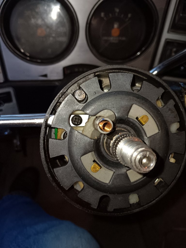

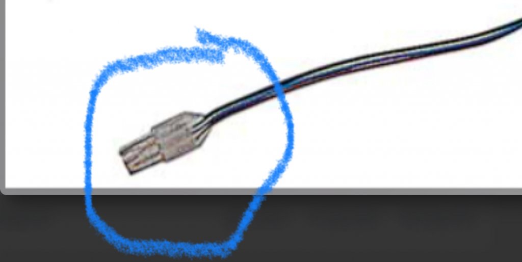

Check under dash and see look for this connector. It will be somewhere around the base of the column, but you won’t need to pull much apart. I don’t think your AC duct will be in the way either. It is a flat connector with two pins on each side. There is no other connector on the truck that fits this male spade which comes from the cruise control arm down the column. The stick just pulls out of the column without tools, it just needs a hard yank, and then line it up and push it back in, so there is a chance someone just replaced the stick if the other one broke.
The above is only correct if you have wipers on the column and no cruise. You still have to deal with the wiring that runs down the column if you have wipers on the column AND cruise.
If you have wipers on the dash the cruise stalk is held in to the turn signal switch with a screw that is not accessible outside the column.
FYI
Pic of screw :
