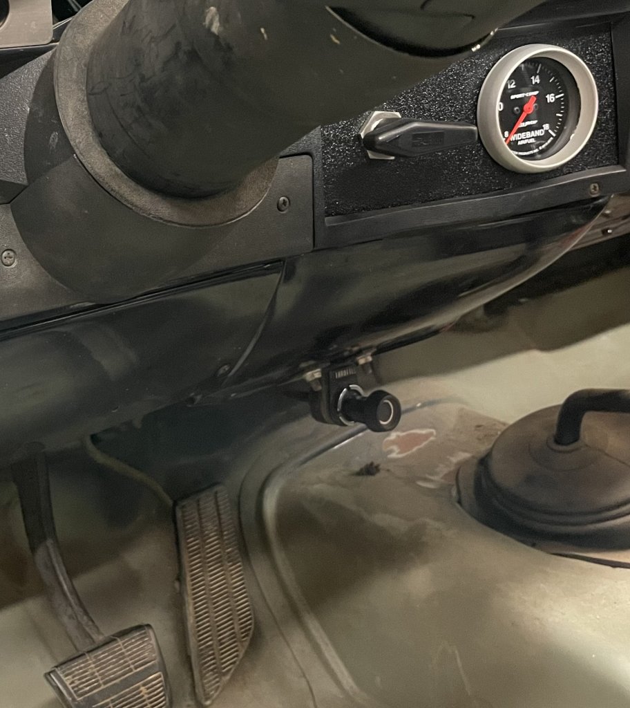

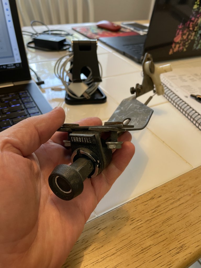

I have a 1973 K10. There is a control located on the left side of dash where the vent used to be. It goes down to the foot feed and is mounted on the unit. It does nothing to affect anything. It does not pull out just turns left and right like a dimmer. It is connected with a cable but does nothing. Anybody ever heard of this. Sorry I couldn't explain it better. It's independent of the throttle cable but it's connected as though if you were to pull it it would make the truck idle higher. I have no idea. Look if you came here to be funny go somewhere else.

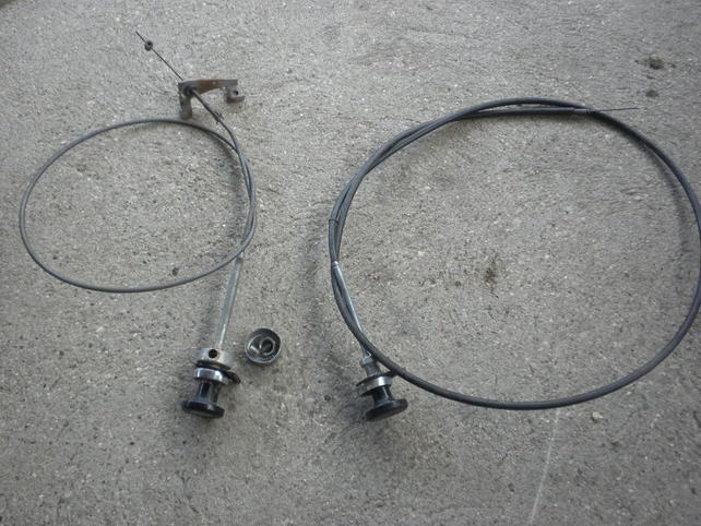

That cable you removed from the panel where the AC vent would be is a hand throttle. One year only, 1973, had the optional hand throttle mounted in that location. That year only you could get AC or the hand throttle, but not both. 1974 and on the hand throttle cable was mounted low on the dash, right above the foot throttle.
Cable operation: Steel spring loaded ball inside set on a coarse threaded cable end. To operate it, pull hard enough so the spring ball jumps onto the threaded part of the dash cable end. Then you can spin the the knob to fine tune the RPM's wanted. Like you stated, when the knob is all the way in, it is not yet on the threaded part of the cable end, so it just spins.
