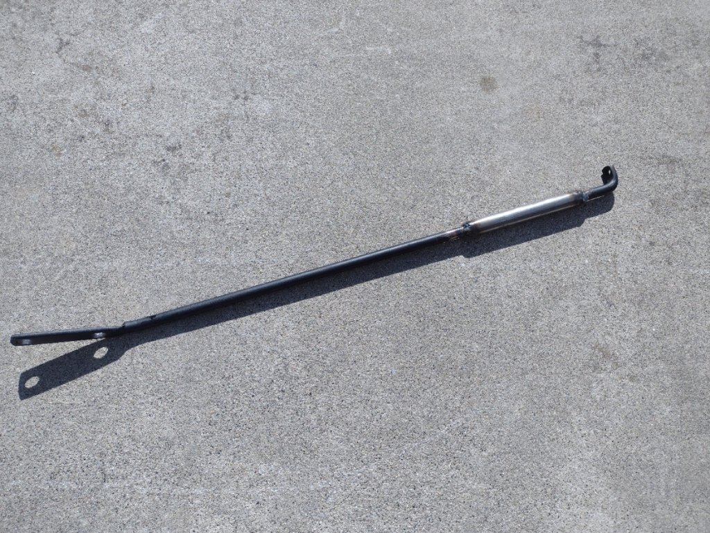

Does anyone make a np203/700r4 transfer case brace? Or has anyone fabricated one?
I’m tired of fighting leaks and I’m hoping a brace is the solution

Piece of rebar, some welded on loops and maybe a little bending

Find a side bar that fits the bolt pattern on the side of your 203 (if it's drilled) and cut / sleeve / extend it to the bellhousing bolt.
That's what I did (see attached pic)
