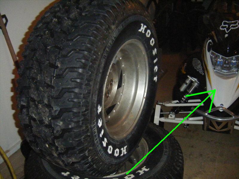

Nice sled! :High 5:

Well my dad said the same thing as you said, break the bondo out, sand it all down then fill it in again. He said they probably just didnt pound the dent out far enough and thats the reason for it all. And yes i hope she doesnt start getting cancer! We will find out in a few weeks though.:grd:
Nice sled! :High 5:
Thanks! thats my 08 yamaha nytro. Got a good deal on it on ebay (or so we thought), turns out it was rolled and the whole sub frame was bent. I have had that sled completely stripped down many times, but its still fun to ride!

oh! and by the way, nice arrows 89suburban
