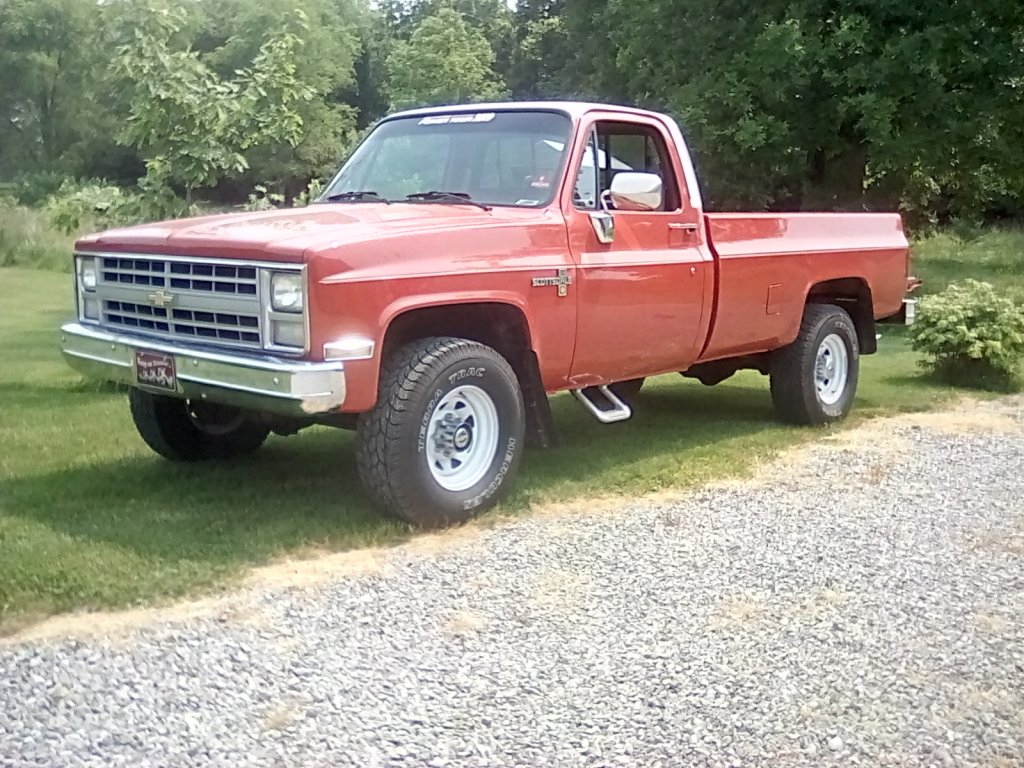

My truck has 79 frame, 86 cab and bed. No issues, used the 79 front bumper which I like better anyway.
