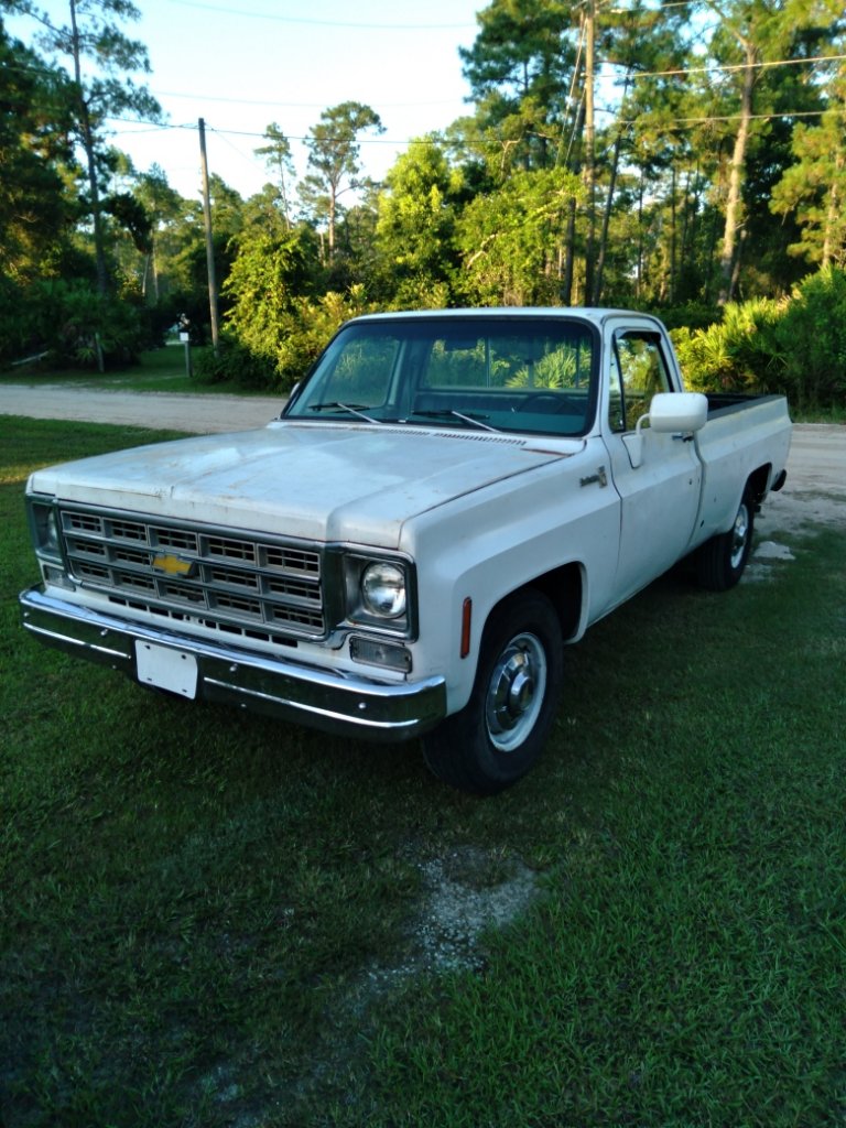

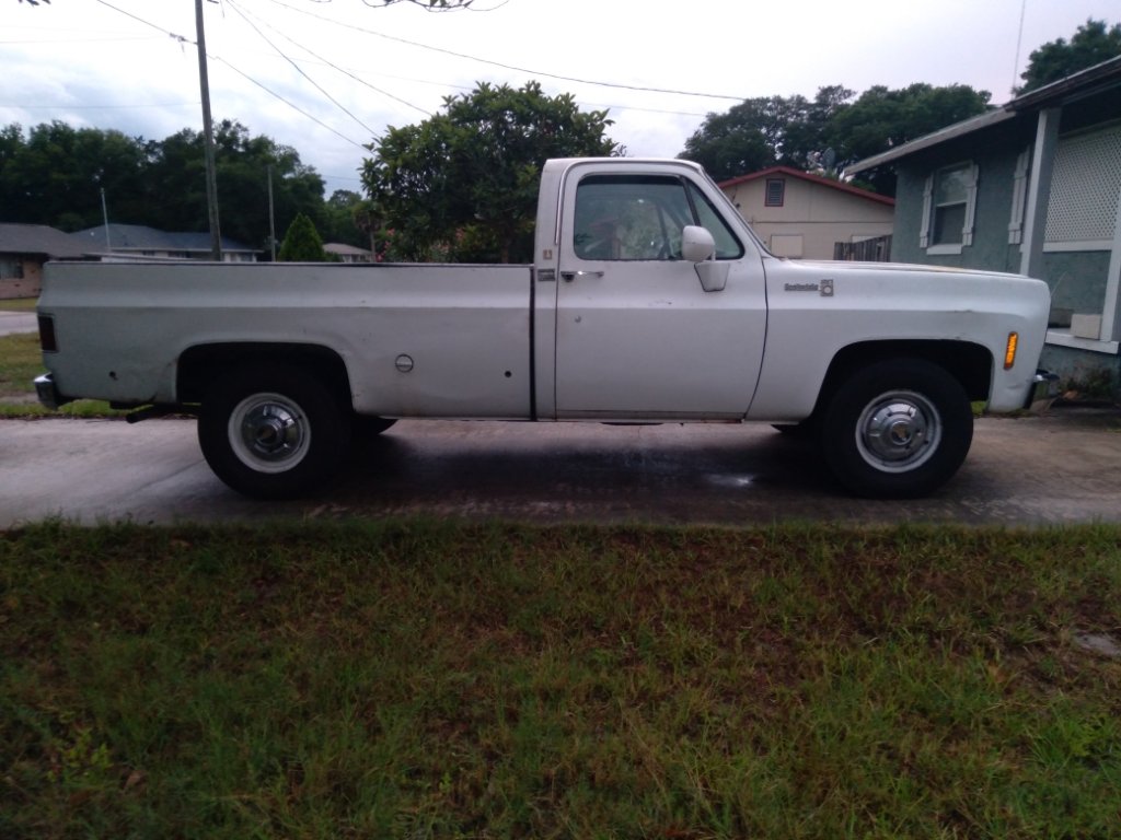

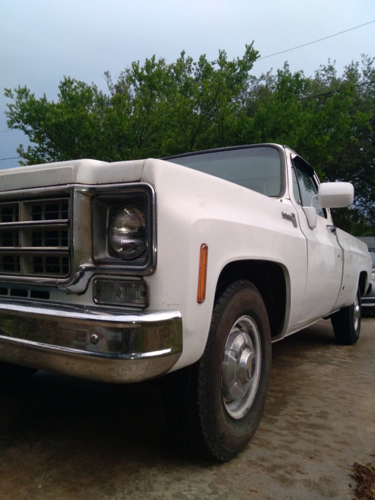

Hello all, thanks for letting me in. Ive been a squarebody fan since I can remember and have owned a few over the years. I currently own a 78 c20 scottsdale camper special. I want to do a few modifications to this truck and im hoping you guys will be able to help me along the way.
Im from central florida and currently a student at a welding school.
Any questions about my truck or whatever just ask :happy107:
:happy160:
My original goal with this truck was to lower it a few inches to make it easier loading things in the bed like dirtbikes. I also would love some fat tires on all four corners. Ive been researching for months trying to make up my mind of what route to go. For the life of me I cant figure out a good wheel and tire combo thats got a good weight rating and will look good. Im on a pretty small budget right now ive got probably 1300 or so for modifications. I dont think ill be able to do new wheels and tires and do the suspension, but i might be able to swing the suspension with new tires on the "stock" 16inch steel wheels for now. From what i gatether, four inches is as low as i can go in the rear without having to cut the frame for a c notch, which id like to avoid. The easiest route i see is a set of 4 inch drop leafs from western chassis, but they run about 600 per set. I cant really make up my mind of where to go from here. anyways, thats my story for now. if i need to ill make another post specifically about the trucks modifications/plans

I've always liked the stance of 3/4 tons the way they came from the factory.
I just use a longer ramp for loading my bikes.

Welcome aboard from East Tennessee. Your stock wheels look great.

If you're really just lowering it for access for loading bikes, etc, I'd leave it alone and spend money fixing it up instead...just me.
If you're wanting the lowered look, front drop spindles = about $300 + misc parts that maybe "should be" replaced at the same time.
You could get a couple/3 inches out of the rear springs and save a little load carrying capability by removing some of the leaves.
Your springs should look similar to this. If you leave (no pun intended) the top 3 or 4 leafs, that will drop it significantly, at least 2".
Tires will look goofy if they're "much" smaller in diameter, but re-using your existing rims, you could get a little shorter and fatter tire.
Regardless, nice truck!
