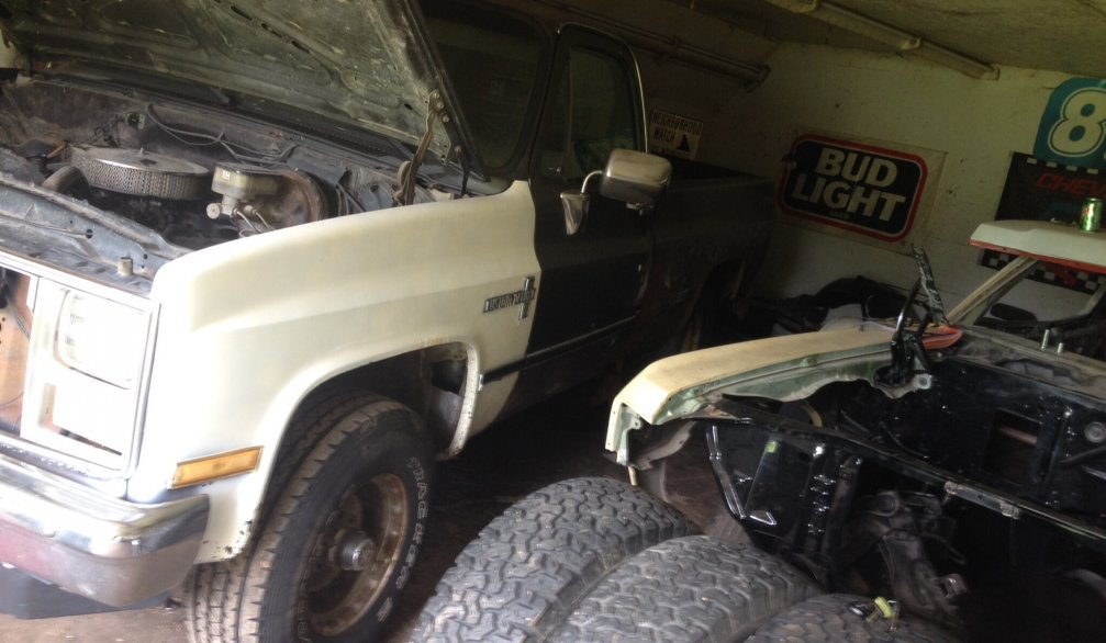

Just a little trunk work

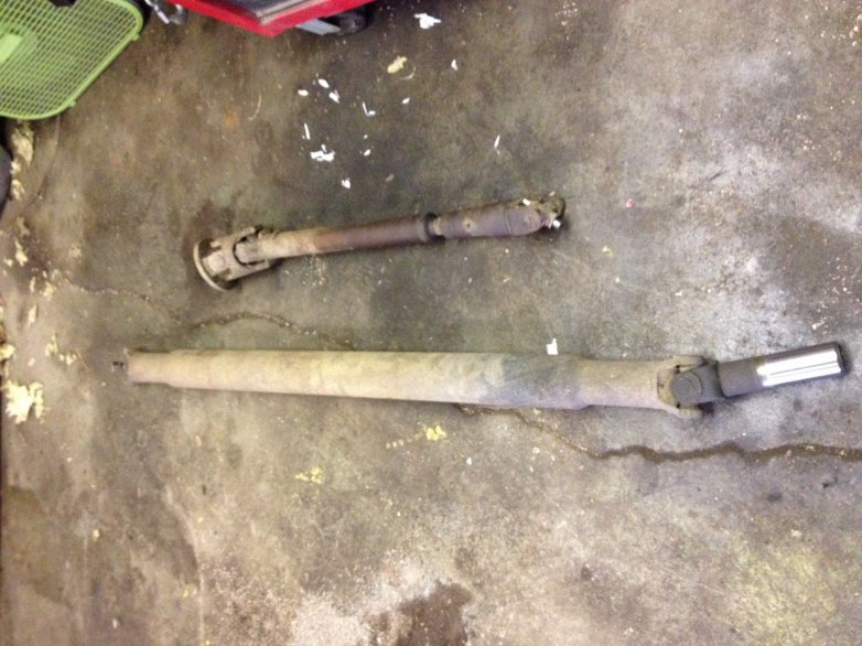

Got the driveshafts and t-case down today, then got called back to town

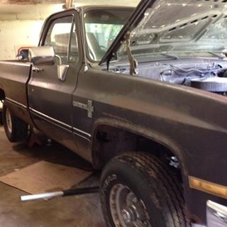

She's a work in progress but here soon it will be a awesome trail/mud rig

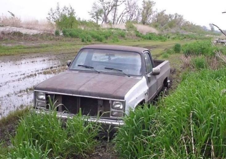

I went through the slop 3 or 4 times and when I turned around to go back the last time it took me down lol then my buddy pulled me out and I thought it was dry and it turned out not to be lol

Lol yeah, field goo can jump out and get you when you least expect it.

We were right by the Missouri River, started out cat fishing and drinking and all we were catching was a buzz so we desided to get a lil mud on the tires lol
