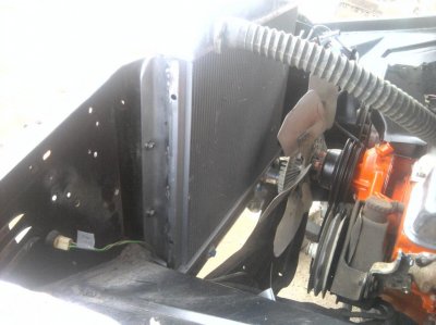

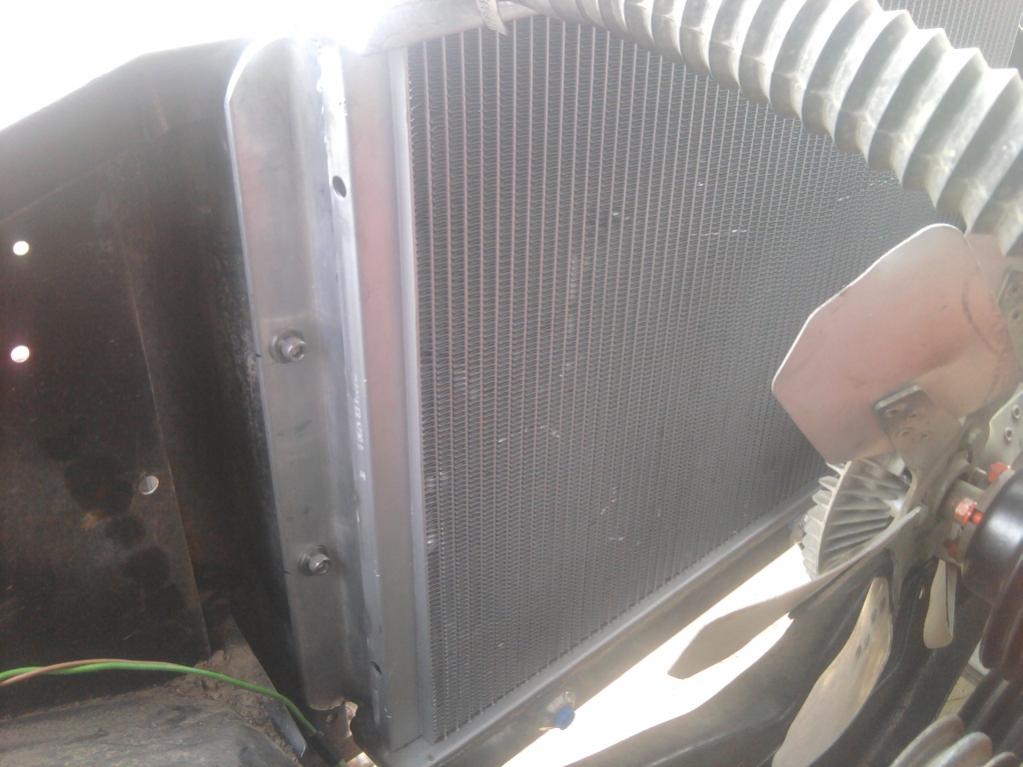

gettin alot done
modified the radiator mount made it a side mount that bolts to the core support kinda like a dodge does. it worked out awsome could not fit the radiator in this truck better if i tried to.
the motor is almost ready to fire just the fuel line under the cab to hook up and distributer cap and wire and plugs and put fuel to it

Man, this is great project. Been awhile since I seen a vertical radiator. My 64 GMC may have been the last one of those I worked with.

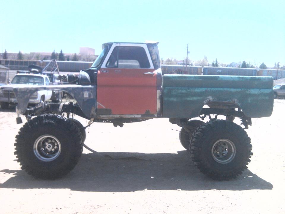

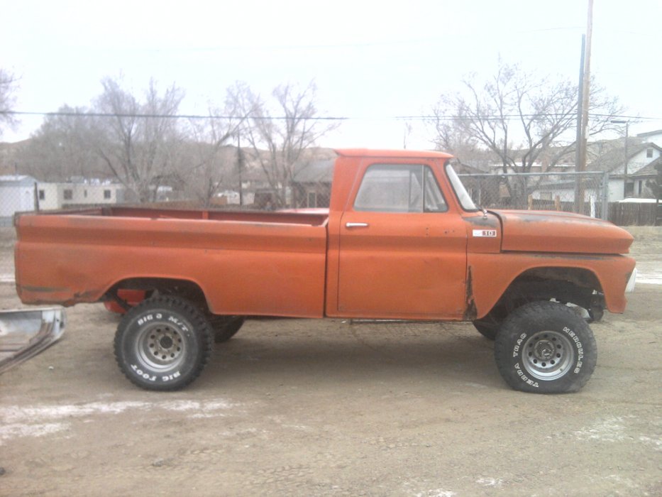

well I think this truck just got shoved into becoming a mud truck
I found out the 12'' lift spring I bought for my mud truck build kleedus they are for the older trucks 72 and down
it has been awhile since I bought them so no chance of returning them and getting the right ones
so picture this truck with 15 inches of lift and 44'' tires
kleedus will not die just its build plan will change a bit
in the picture of the short bed you can see the rear shackle angle is way wrong the springs are to short for the 87 chassis I put that body on
