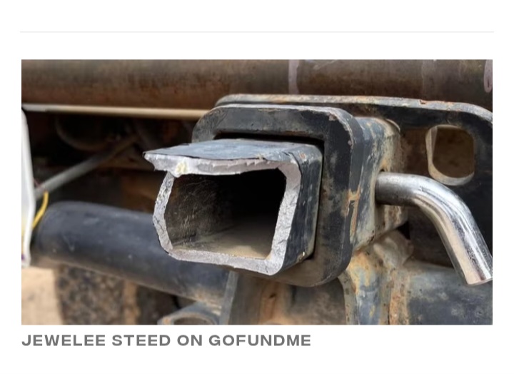

I have done this many times and not cut the strap. But is the pin strong enough? Looks like the pin is still intact in the pictures where the hitch broke.

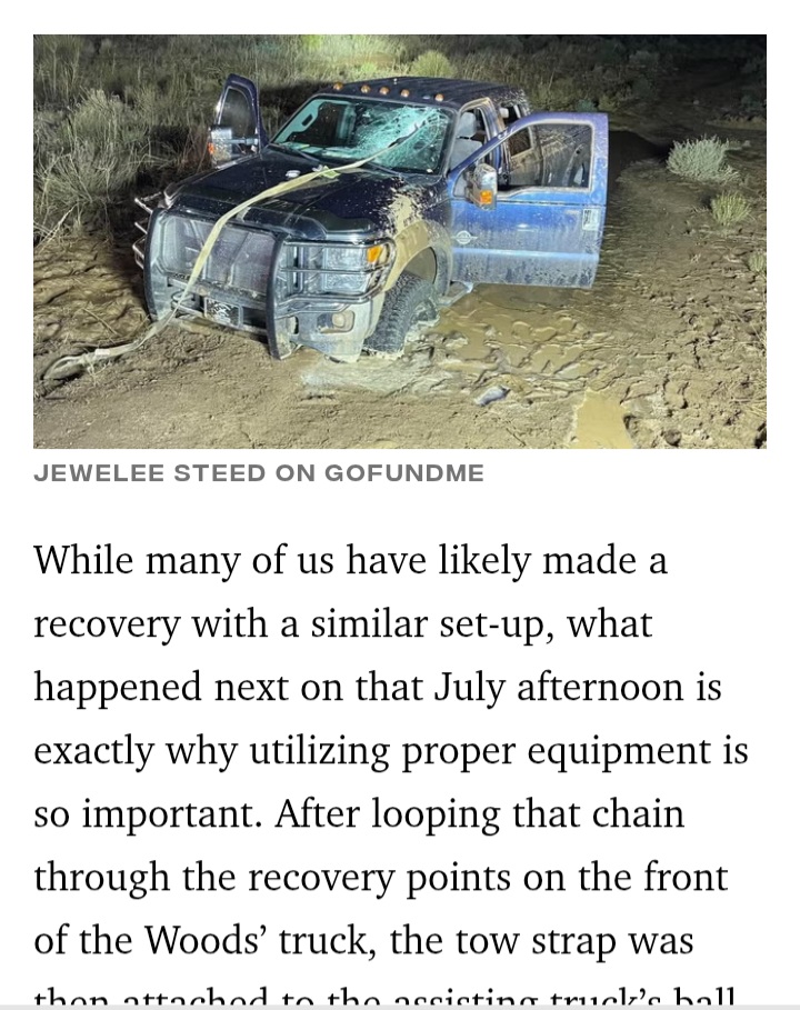

Reminder,this man was killed trying to jerk a truck loose. And this was with a strap, broke the end of the receiver off,sent it through the windshield. I doubt a strap blanket would have helped,but couldn't have hurt
