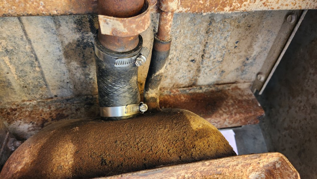

Need to replace rubber fuel lines on top of both tanks….

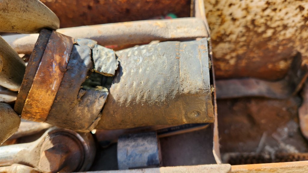

Hi! All bed bolts were like new condition so i guess i got lucky. I was able to move the bed back enough to work on the sender units, new fuel lines. Thank you for your help!

I installed a new take and lines without removing the bed on the truck I have now. My first square, the red one in my profile picture, I did with the bed off. I had the bed off anyway to do some work on it. If you replace the lines that you can see between the cab and the front of the bed like in did on my last tank swap, I found that the new rubber gas lines kinked when I lifted the new tank into place. I finally used some 5/8 inch inside diameter garden hose over the top of my gas line from the top of the tank to the hard line inside the frame. That made it stiff enough not to kink and gave it some added protection.
