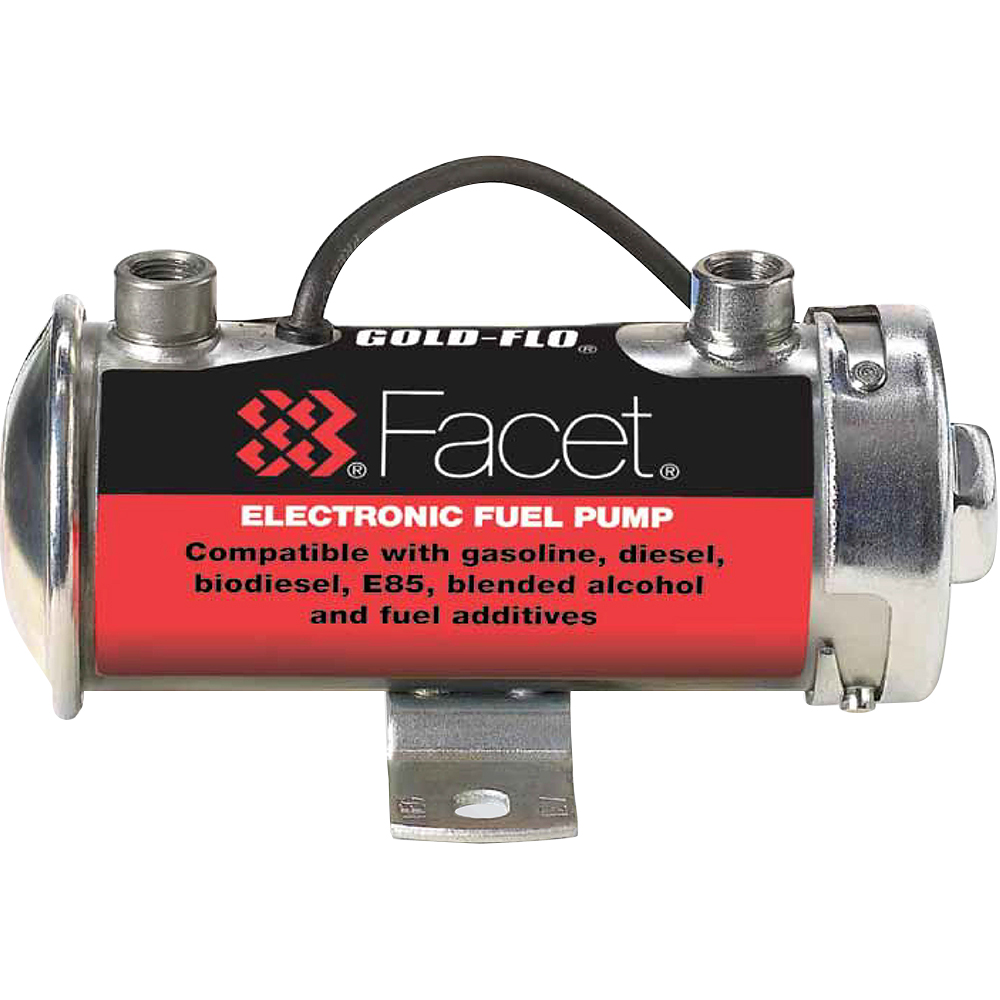

IF you want to install an electric pump, buy once cry once. Facet Interrupter pump.
