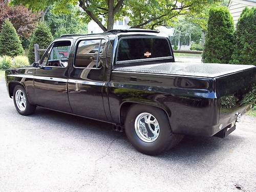

Anyone know this truck? This is the only pic I can find and can't seem to find the origin of it.
