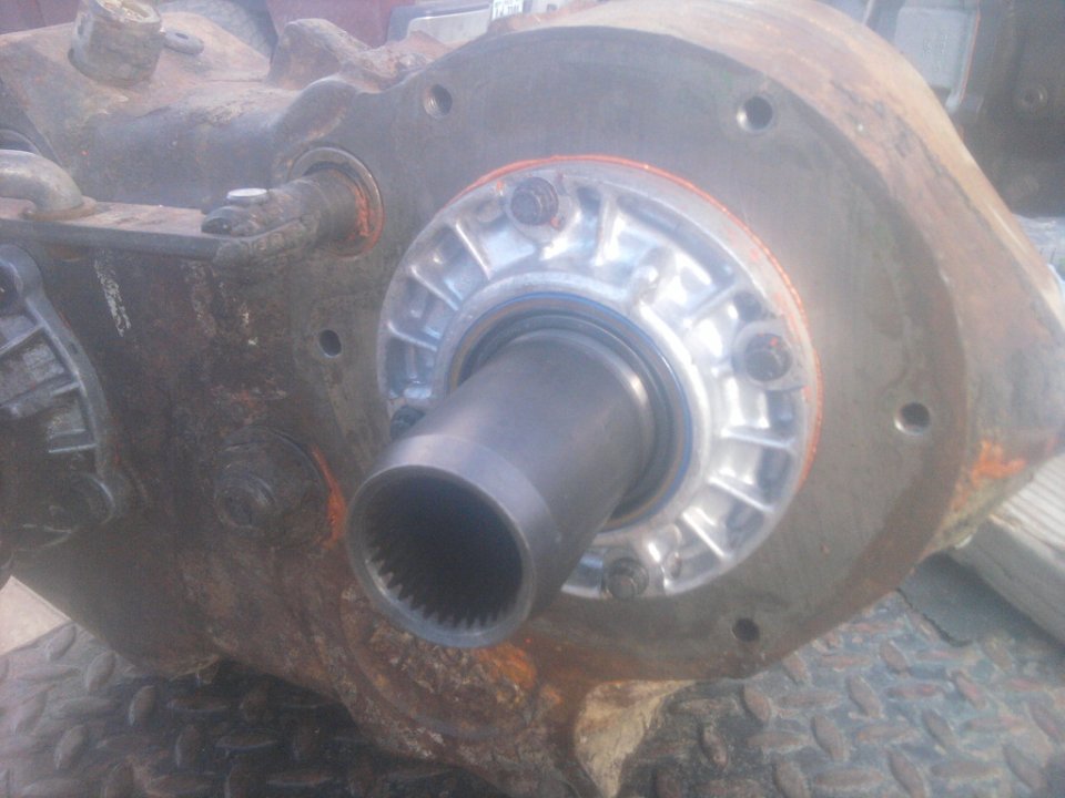

just a public service notice here
before you put your 205 on the tranny and every time you take your t case of change the input seal and use the double lip seal. even if it looks good change it its cheap.
the oil for a nv4500 is really expensive and you do not want it mixing with your t case oil. a lot of nv4500's have been destroyed because this seal failed.

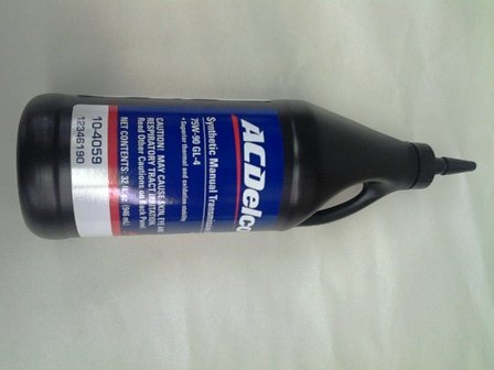

the oil for the nv4500 is a special oil just for the nv4500 since it has carbon fiber syncros
the 205 calls for normal gear oil
even if you run the same oil you still do not want the oil draining into the t-case from the transmission it will overfill the t-case and the transmission will be low
