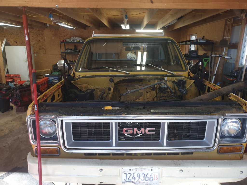

So I'm getting the engine put back together on 'Ol Yeller, and I was thinking "Would a Muncie 4 speed be a good option for a truck?"
These trucks never came with them, but it's got to be tougher than the saginaw 3 speed already in there, right?
At one point a few years back, I did briefly have a Saginaw 4 speed installed in place of the 3 speed, and it didn't last long at all (My burnout attempt may have something to do with shattering reverse). Would a Muncie fair better?
