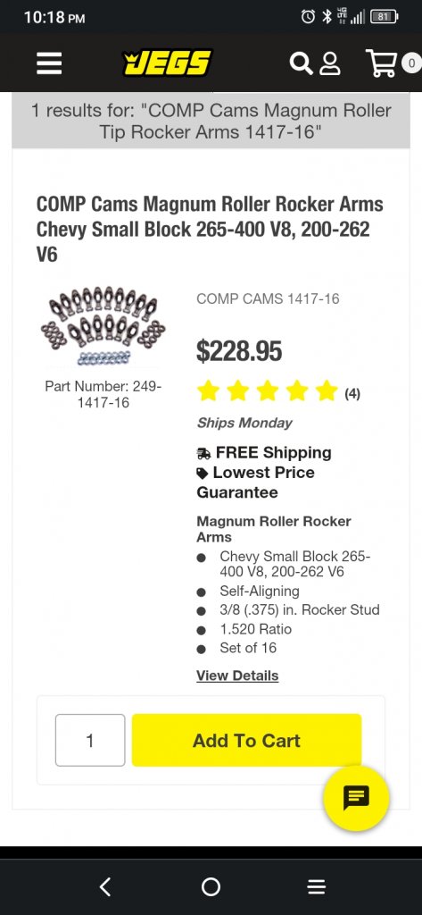

Some of the best realization in aftermarket rocked arms is found after the lift of each valve becomes the same.
Factory tolerance was not the greatest control ever. Ensuring uniformity will realize its' own gains, not giving mention to increased lift and improved flow. Your current factory 16 rockers allow for a LOT of variation across the engine and between each cylinder. In reality, Uniformity is vital.
These are a common, popular choice.
Be advised other weak links may become apparent after installation. It's hard to go wrong and you will probably have to buy new valve covers.
Installation can certainly open other doors but getting them settled is certainly a necessary step in the right direction and can be fun...your engine will thank you for tossing the stamped steel units, for certain... it will become a different animal - after all the valves lift the same. That is difficult to overstate.
The factory tolerance was not the greatest control ever. Ensuring uniformity will realize its' own gains, not giving mention to increased lift and improved flow. Your current factory16 valves allow for a LOT of variation across the engine and between each cylinder. Uniformity is vital.
Installation can certainly open other doors but getting them settled is certainly a necessary step in the right direction and can be fun...your engine will thank you for tossing the stamped steel units, for certain... it will become a different animal - after all the valves lift the same. That is difficult to over state.

Later on I thought about self-aligning rocker arms and changed the picture to reflect a different part number that is likely more correct for your application.
So you are taking my current heads into account? I hope so. I am not sure I will be making a change like that soon. So a 1.5 ratio rocker arms, but rollers.

Adjusting rocker arms will be the same.
I only assume you run factory TBI heads, 091 or 093 likely with the swirl ports.
Those do in fact require the self aligning type or rocker which is why i changed the picture, the answer to your question is yes. Those rockers are also required for an 083 head, so they would transfer if necessary.
To be very clear - the main benefit of running after market rocker arms is uniformity. The allowed variance found in the factory units will make you puke. All of the factory rockers do NOT lift the same. You will always have certain cylinders stronger or weaker than the others. Rather you choose a full roller or a roller tip rocker, aftermarket parts will be superior because the quality control is better. The Comp Cams are cheap , strong, and very popular but you could spend a BUNCH more on 16 rocker arms if you want to.They will all be the same. Again, it's difficult to overstate.
Not like a 1.52 is a huge gain over a 1.5, but you can probably install those without opening too big a can of valvetrain woes like coil bind and new pushrods. They are pretty much bolt on spare whatever fun changing the valvecovers has to offer. Cuz there will be some...no doubt. Like bending your AC lines and finding a place for the various valve cover mounted sensors that will lose their brackets. Needing longer vacuum lines, etc. ... All part of the fun. Totally worth it and a necessity of truly hauling ass and roller tips really help it run smoother.
Like you said, the little changes really add up but changing rocker arms is kind of a big deal like rebuilding a differential but not really. It will make a huge change though.
You can do it alright and you might as well change those first so you can get that mod settled in good and proper.. it'll take a while.
