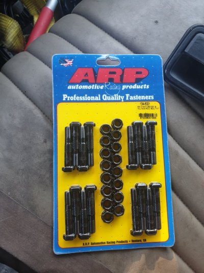

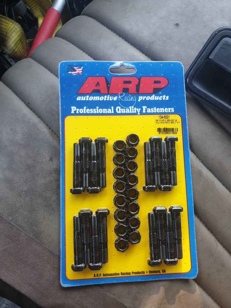

Just picked these up today, the guy at the speed shop told me he had made the same mistake I had before, and that replacing them while in the engine is totally doable.

Hmmm, my opinion/concern is that you upgraded to an ARP bolt(200k psi?) which is going to stretch different than a stock bolt(140-160k psi). In my opinion, if you aren't going to resize, I'd look for a stock, used bolt.
When I worked at PAW, we resized probably a 1000 rods a day and on 99% of those stock bolts were reused after verifying they fit in a go/ no go for stretch. New nuts were always used. There was no way to tell other than that gauge if a bolt was abused, under/ over tightened in the past and probably a few million were done that way with a handful of engine failures attributable to a true failure of the bolt. Most of the failures were believed to be from undertorqing a bolt evidenced by the wear marks and no stretch.
Please don't take this the wrong way but not all counter salespeople are equal, but...a guy that is probably on commission and sells parts for a living told you it would be ok, because he did it once but isn't doing the work and won't help you when it breaks by either holding the flashlight or with some $$$, isn't who'd I believe.
