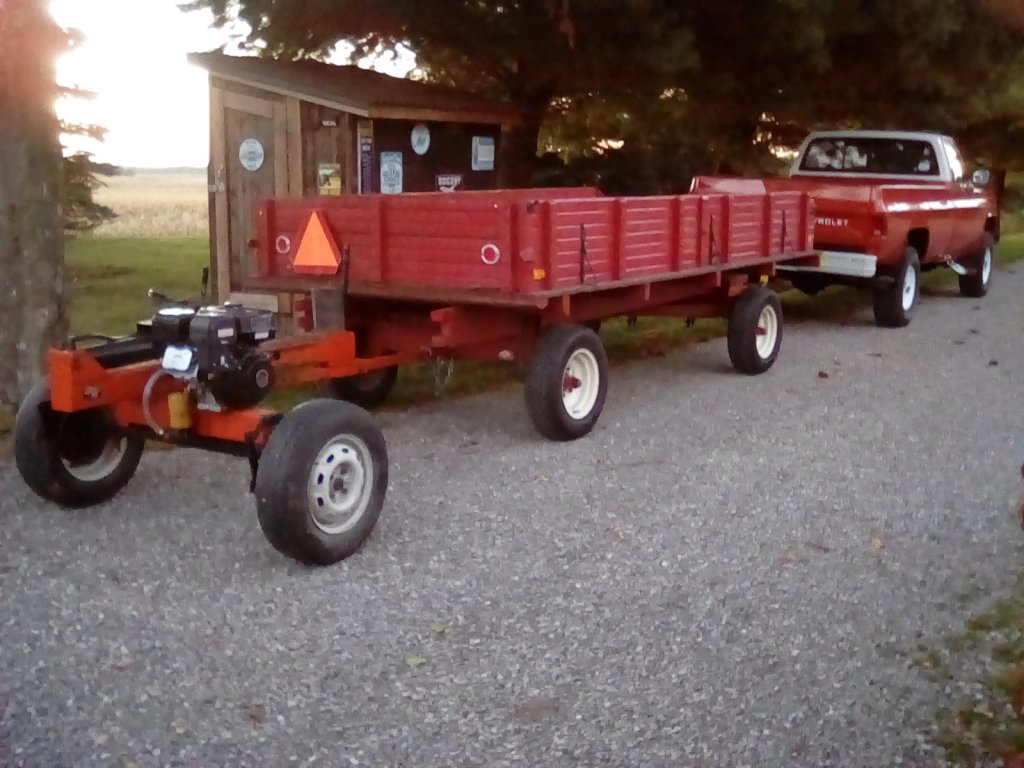

Should I coat both sides prior to fastening the wood down??
It would not hurt to give the bottom and sides a coat. Then coat the top every year or two. I have an old flat deck wagon that I rebuilt 35 years ago using rough sawn white oak. I routed the tongue and grove on the deck. It has hauled firewood, mulch, slab lumber, etc. It's been kept inside but suffered it's share of pop up rain storms. It gets a slather of boiled linseed every3-4 years. Looks like new still.
